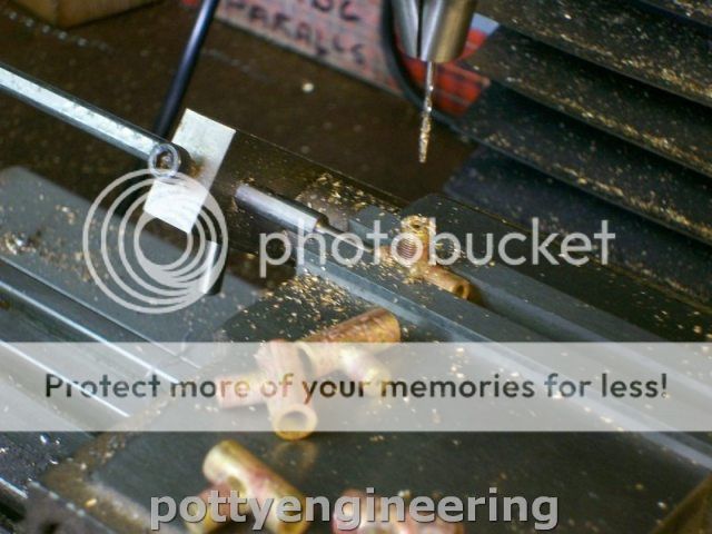

So now to make them first job the body this is simple enough to do machine a length of brass to the required OD enough to make all the cocks required and part off to all the same length.
Then chuck them up one at a time drill through No13 drill and tap each end 7/32"*40 ME

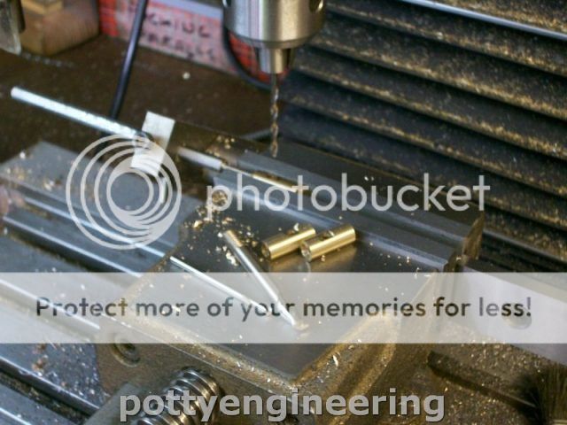

Set the mill up to drill a 3mm hole part way through to attache the T peice using the vice stops helps with this. and with a slot drill mill spot a small flat.
Thats that bit done.

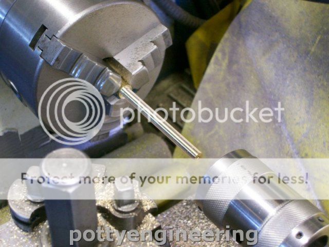

Then turn up a length again to do all the T peices required and thread 1/4"*40 ME and part off to required length, put a small centre in each one and at the other end turn a small pip a tight fit in the 3mm hole in the body, press them into the body making shure they sit down square on the flat.

Drill through the T peice into the body this is easy to pick up on the centre drill hole particularly if you have left the mill set up
Set the ball onto its seating by giving it a sharp tap with a hammer throw the ball away and replace with a new one after this as you'll knock it out of shape.

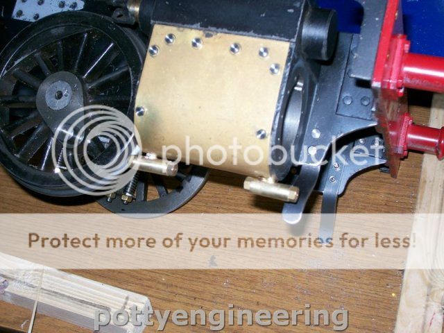

And this is where they fit on the loco
I have a few unused bodies left if any one wants to try them just let me know what size you're cylinder is tapped and I'll finishe them of and post them.
I just have to keep my fingers crossed know that I've drawn it up correct and that they work.
