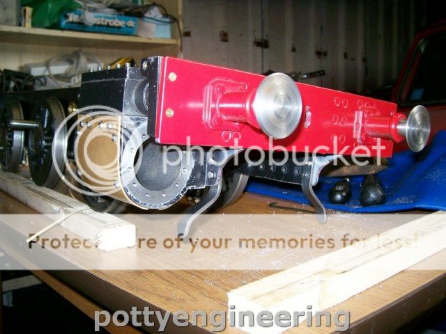

I had to do a bit of reworking on the cylinders and steam chest this consisted of cutting one of the steam ways into the cylinder making some studds for the steam chest milling one of the steam chests down so that it didn't foul on the frame when the cylinders were bolted to it and fitting cladding to the cylinders.
her's some shot of the cladding work.
Marking out the cylinder for drilling and tapping.
Tapping the drilled cylinders
Measuring the the required length for the cladding by bending a bit of wire to the shape then straightening the wire out and measuring its length.
The cladding was made from a  bit of 1mm ish thich breass sheet it was anealed firt so that it could be bent to shape then the holes and cut outs machined.
Another part that was required were the guard rails I think this is what they are called, their function is to stop the loco bottoming onto the cylinders if you have a derailment hence saving the cylinders and other bits from damage.
There wasn't any holes drilled in the fram to take the guard rails so I made up a simple mild steel jig clamped this at the apropriate position on the frame to locate the hole for drilling through with a hand drill.
The guard rails were machined out of some 1/8" mild steel and bent to shape.
Here they are fitted along with a clad cylinder.

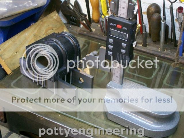

One of the things that I've been strugling with, is just how good do these things have to be, I know that for the thing to go round corners and for the axles to go up and down and for the thing to stay on the track you need some slack in the system but no one can tell you how much
Time to get a grip of the situation and get the bloody thing sorted
Up bright and early on in the shop after a bit of a rummage in the old stash i found the cast iron that a Guy gave me some time ago , a quick measure and whoopee I have enough for the axle boxes.
Next a rummage for some steel to  make a puller and cam up with this bit of garage door
Saw it in half then stick a 3/4" through the midle and a couple of 10mm clearance holes at each end, cut through into the 3/4" hole so that it makes a yolk to slip round the axle.  Drill and tap the middle of the other peice M10 two more 10mm holes at the end to match with the first peice.
So you've got this
I was telling one of the Guys at the club about my problems and he said the way to heat the wheel up to deactivate the loctite was do it nice and gently with a paint striiping heat gun:- so zapped one of the wheel for about 10 min to get it nice and hot then using leather gardening gloves assemble it to the puller.
Tighten the centre bolt up to give it a gentle squees and slowly she came off.
Repeat with the other axles and the jobs a good one.
This allowed the removal of the crap axle boxes, you can see one of their problems her as they were too narrow and the guys had bushed them with phos bronze bearing there wasn't enough meat to take them and the hole broke through the side.  :facepalm:
One wheel is pinned  to the axle you can see the pin at the 5 oclock position on the left hand wheel axle.
The next big decision is do I drill out the pin and make new axles, or do a leiv them and make the bearing bushes to fit.
Stew
