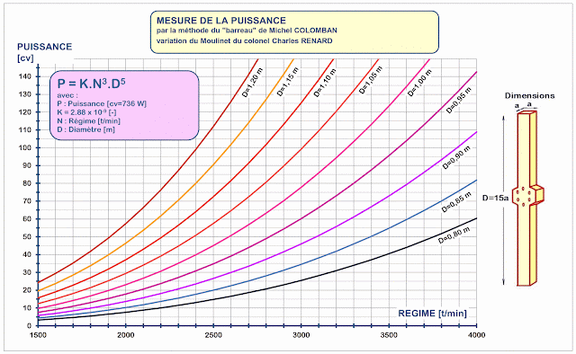

Offline Niels Abildgaard
  • Posts: 173
Re: .90 cu in, 30,000 RPM, 7.2 HP custom built nitro engine
« Reply #352 on: March 04, 2019, 04:37:24 PM »
Jim has a very high accuracy water brake - see earlier in this thread.
But some of the rest of us might find a cheaper / simpler measuring device interesting - more details please - though maybe in a separate thread.
Aircraft engines has been tested for ages with  rotating wood blocks
http://4.bp.blogspot.com/-2DEoFo4Va9g/VfctF7G_DtI/AAAAAAAAP2c/FVKGF4-vSP0/s640/MOULINET_COLOMBAN-RENARD.gif
