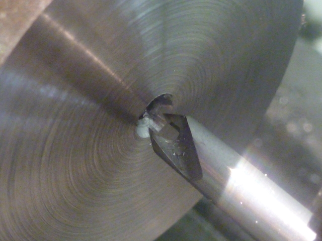

Drilling a large hole without a drill.
« on: June 11, 2014, 05:59:58 AM »
Hi everyone
I recently needed two 35mm holes in perspex. As large drills are expensive I made a boring bar to be held in a chuck. A pilot hole is drilled to stop the boring bar from wandering off center. The boring bar needs to be a neat fit in the pilot hole. I have used this method  on aluminium and steel. If used on metals a very slow speed is used and also plenty of coolant/cutting oil are needed to help the cutting action.
The photos and video show how it works.   http://youtu.be/Mr6hTa7z_AI

Nice job, I have always drilled such holes with a holesaw.
Thor
