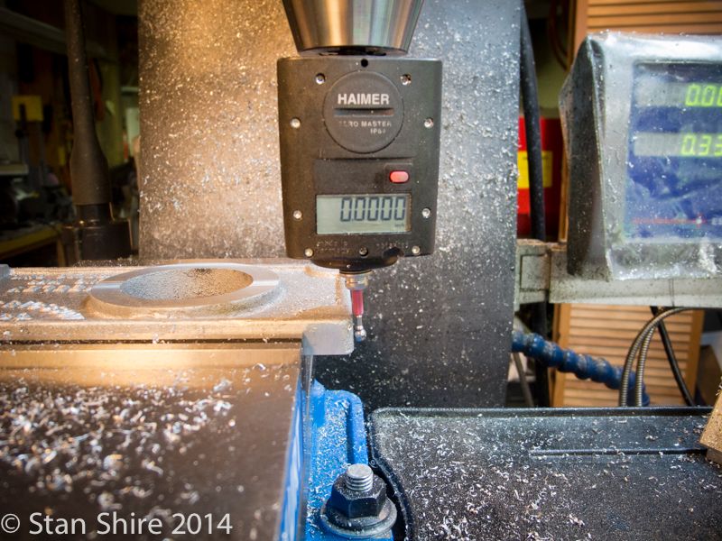

I trammed the mill, indicated the vise and gave the Bijur oiler a pump, so, off we go.
Some fettling to remove the flash from the base, then, the tall vise jaws get installed.
First, milling away the gate from the base casting. I wanted to be sure that I had a reasonable surface for the vise to grab when the bottom of the casting was milled.
Then, once both edges were clean, the bottom was milled flat with a 45° face mill.
Then, flipping the part over to mill the cylinder mounting face and the pad for the flywheel bracket.  The drawings spec a 0.63" height for both of these surfaces.

The next operation is drilling three thru holes at the corners. Each corner was indicated, spot faced and drilled. For the spot facing, I raised the knee until a complete circle was visible. Just a few thou.
The last operation, at this time, was to drill and tap a blind hole 8-32.
