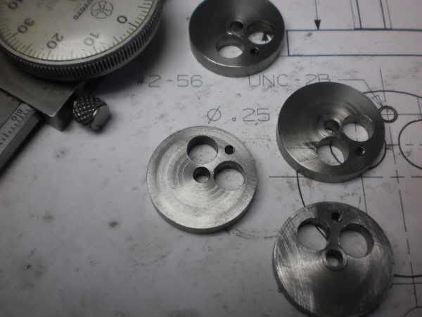

Now for this afternoons progress.

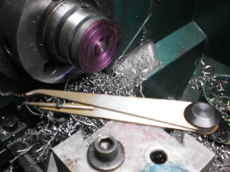

Using some stainless turned up dia and drill crank shaft hole and faced off and asjusted over .007 and feft a .188 dia to ride against center of bearing.
bearing side complete ready to face backside to proper width.
Now to the mill mounted in a 5c collet block drill and tap 2-56 UNC 2b rod journal mounting hole.
Drill counter balance holes.
Disks completed.
