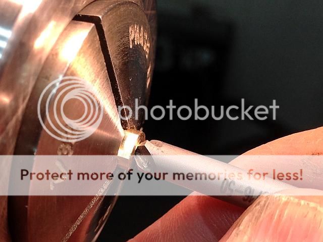

Re: Dieter Hartmann-Wirthwein patent engine
« Reply #36 on: March 15, 2014, 11:27:03 PM »

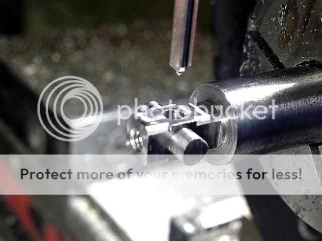

Getting started with the simpler yoke that is used in the outer cylinders.
A piece of 0.281 brass rod was surfaced on two sides to form a "Double D" shape with the sides 0.172 apart and finished to length.
Then the wrist pin hole was drilled and reamed 0.094 in the mill.

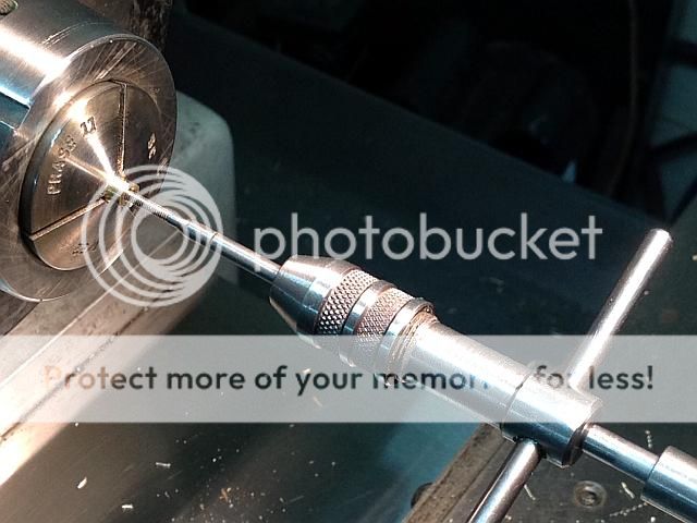

The part was then moved to the lathe and a hole was drilled and counter sunk so the part would sit flat on the inside of the piston crown.  It was drilled into the wrist pin hole.
And finally tapped 2-56 to take the mounting screw.
Gail in NM

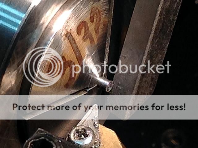

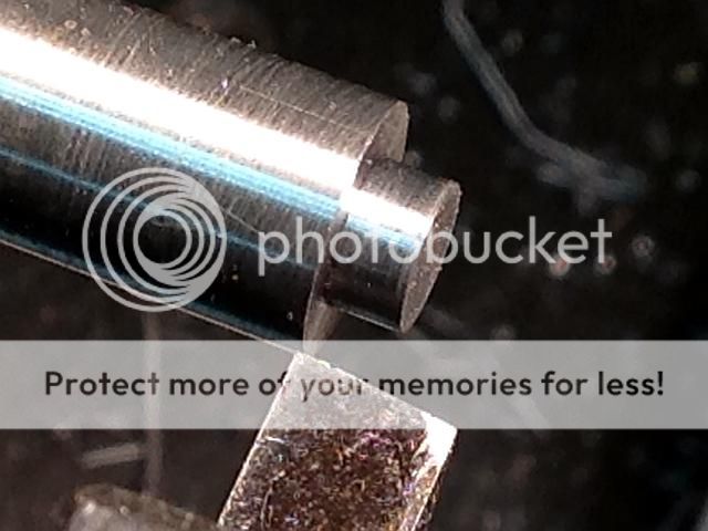

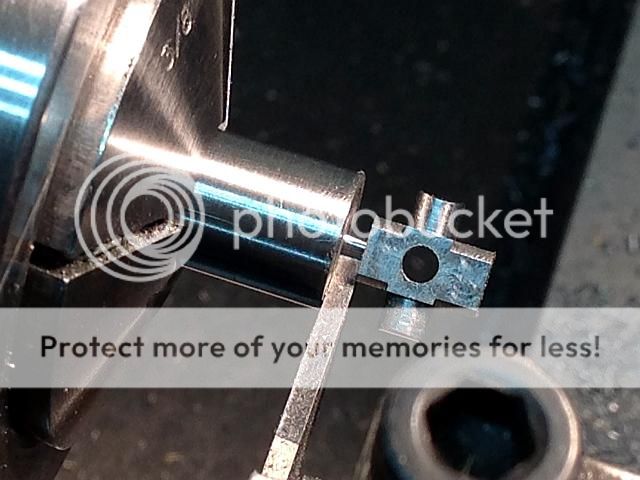

« Reply #37 on: March 16, 2014, 12:28:22 AM »
The yokes for the inside cylinders are a bit more challenging. In finished form they have two intersecting wrist pins of 0.094 diameter.  While the other yokes were made of brass these yokes are made of steel as two stub wrist pins are machined as a part of the yoke. Steel is needed both for strength and for a bearing surface for the small connecting rods.
I started by blanking out the yoke on the lathe using 3/8 diameter 1144 steel.
Then the bar was transferred to a spin index on the mill where the sides were milled off and the pins rough turned using CNC.  As the pins will be turned to finish size later the pins could be roughed out to 0.100 square on a manual mill and fitted into a 9/64 collet or an ER style collet on the lathe for turning later.
While still on the mill, the hole for the other wrist pin is drilled and reamed 0.094.
Then back to the lathe where the yoke is parted off long and then reversed into a 0.218 collet and finished to length. The blank was turned long to allow the end mill room for roughing out the stub wrist pins.
Finally one of the stub wrist pins was pun into a 0.125 collet and the exposed end finish turned and polished to 0.094 diameter. Then it was reversed into a 0.094 collet holding onto the just finished pin and the other end finish turned and polished.

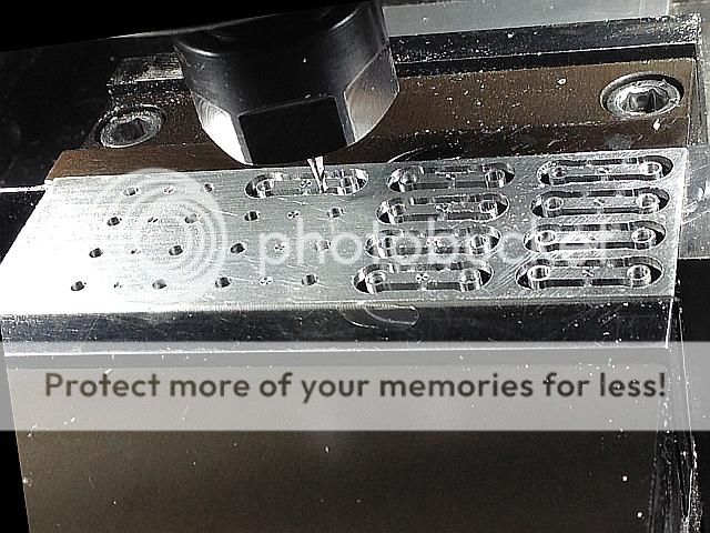

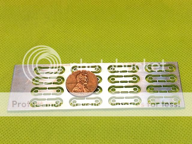

« Reply #43 on: March 17, 2014, 07:25:09 PM »
Thanks for the comments Don, Zee and Kim.
I spent much of my working life in industries where small was a requirement.  You had to get 12 pounds of "stuff" into a 5 pound bag because if you didn't the competition did.  And then the next year you needed 13 pounds in the same size bag.  Old habits die hard. Now my brain still has the same mind set butl the eyes and fingers don't always cooperate. But is good therapy to keep me going.  But I promise no more 1/16 inch bore and stroke steam engines like in the olden days.
I found a bust in my CAD drawings.  A stupid snap to the wrong place that then propagated to several more detail drawings.  It will take a couple of hours to clean them up.  I did get the cylinder heads detailed out enough that l could order material for them, which I did a few hours ago.  And, as they were not affected, I made the short connecting rods.
In the first photo you can see a 1/16 diameter spot in the middle each rod.  This is to identify them as being made of 6061 alumninum as the final ones will be made of 7075.  I only need 8 for the mock up blut of course I made extras to feed the swarf bunnies.
Here is the other side so you can see the three small tabs used to hold the part in place for the final finishing operations. They are 0.007 wide and 0.015 thick.  You can also see that I did not all the exit burrs from reaming off the parts on the right end. They are gone now.  Just have to clip the parts out with a pair of diagonal cutters and file off the bits of the tabs that are left.
Gail in NM
