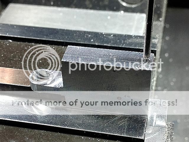

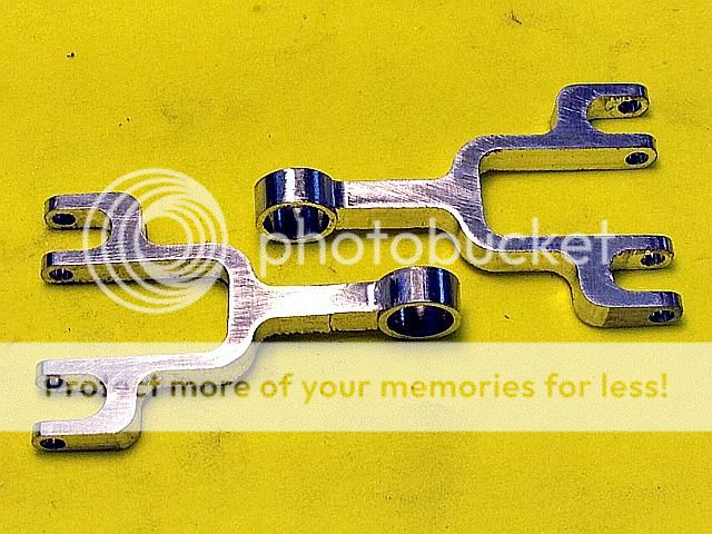

Nothing like making the first part to commit you.  First up is the forked connecting rod.  I chose it because it will be the most complex part to machine and because it is the part will be most likely to give interference problems.
Friday night, day before yesterday, I blanked out two parts.  By mid morning Saturday I had screwed them both up with stupid mistakes so I got to start over again.
A blank was made, actually 2 so I could screw one up and still get one good one. It  was finished accurately to thickness and width and one end squared up to use for a reference.  The other end is just saw cut and will get machined off early in the machining.

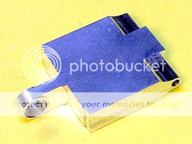

The big end was machined on one side and the part flipped and the other side machined.
The big end hole wad drilled and reamed.  Then the small ends were drilled and reamed from both sides.
A radius was put on both of the small ends.
And it looks like this so far with all the edge work done.

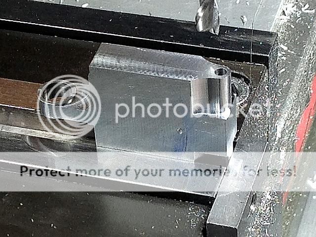

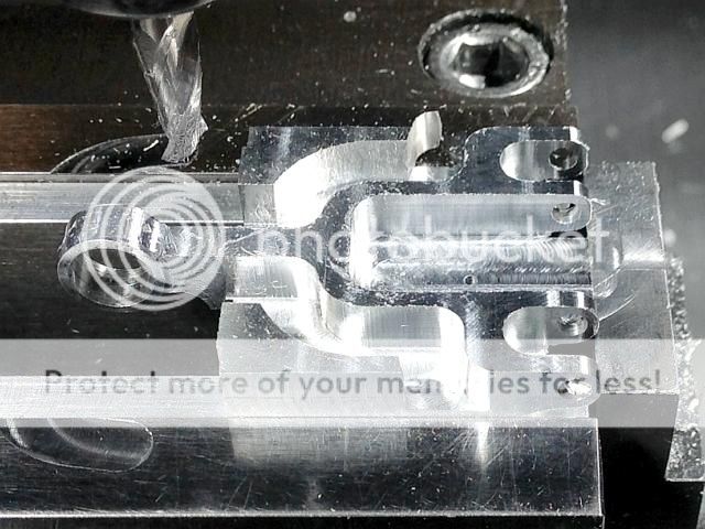

The contours were cut on one side holding the part on parallels in the vice.  Not much to grip on, but enough.

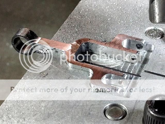

A pocket to hold the part was machined into a 3/16 thick set of plate softjaws in the vice.
The excess material was machined off the second side down to the contour that had been cut thus bringing the part to final thickness .
And as luck would have it I did not screw up either of the two blanks so I have two parts that agree with my drawing.  If they will work will be seen later on.

Thanks Zee.  The photos are all of 6061 that I was using to proof out the steps.  It went well enough that while I was set up I made two more out of 7075 in hopes that I won't have to make any changes. But you know what the odds of that happening are. ;D
