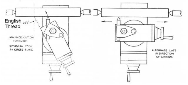

So, I spent a couple of hours tonight trying to figure out how to adapt some of Rudy's fixtures to my equipment.  The way I came up with required me to cut some threads using my new lathe :) this is a new experience for me :)  So tonight I just tried an experiment.  It came out kind-a OK.  Good thing it was just practice.  I remembered lots of things I've seen other do as I was executing my experiment.  And its amazing how much sense it makes when you are trying it for yourself.
me... "Oh, THAT'S why people cut a relief behind the  last threads!"
Me again... "Oh, THAT's what it looks like when you cross thread cause you didn't start on the right number."
And again... "Oh, THAT's what people mean by 'cutting on the leading edge' and why they say you should feed in with the compound slide set to 59.5 degrees.
But I've never heard people talk about how you have to divide the thread depth by Sin(60) in order to get how far you have to feed the compound slide in when cutting the threads.  Do others do this and I just don't remember it?  Or did I do something unnecessarily complex?  (and potentially make my test threads too loose?)

The compound rest infeed for 60 degree American National Threads for the various angles are:
External Threads:
Depth of Cut @ 30 deg. = .75/ N, where N = No. of Threads Per Inch (TPI)
D.O.C. @ 29.5 deg. = .746/ N
D.O.C. @ 29 deg. = .743/ N
Internal Threads:
D.O.C. @ 30 deg. = .625/ N
D.O.C. @ 29.5 deg. = .622/ N
D.O.C. @ 29 deg. = .619/ N
These formulas are based on the tool having the proper flat on the threading tool. For External Threads that is W = P/ 8 and for Internal Threads W= P/ 4, where W = Width of Flat and P = Pitch = 1/ N, N = Number of TPI.
Remember to double this result if your compound rest reads Diameter Reduction directly. Fortunately, if you dial in the total compound rest infeed and your thread looks incomplete, you have direct reading dials and the number must be doubled.
My preference when single point threading is to infeed with the compound rest at 29.5 degrees and stop .003"- .005" short of the total infeed depending on how coarse the thread is. I then check the pitch diameter with a set of thread wires, which are not expensive or a thread micrometer. To finish the thread, I feed the remainder with the cross slide .001" at a time taking free passes along the way to bring the thread to the correct pitch diameter.
By in feeding the threading tool with the compound rest at an angle slightly less than one-half of the included angle, transfers 7- 11% of the total depth of cut to the trailing flank of the tool. Sorry, too tired to get up and find my notebook at this time! Sometimes, if you infeed at 30 degrees (or 1/2 of the included angle of the thread) the trailing flank of the thread can be scarred when you are taking the first passes and that damage will appear on the finished thread because the tool follows that same path along the trailing flank. By in feeding at 1/2- 1 degree less, you are taking a bit off that trailing flank with each cut. By taking the last finishing cuts with the cross slide straight-in, you are also taking a finish pass on all three surfaces of the thread: leading flank, trailing flank and the root.
Enjoy your next build. I will be following along.

Hi Kim,
The 2 ways of cutting a thread on a lathe.
Hope it's useful.
Best Regards

Thanks Achim,
Yes, this project should let me practice my repeatability, that's for sure!
Thanks Mike, Bob, and Stewart,
I am reviewing several YouTube thread cutting tutorials now and as I said, its amazing how much more you pickup when you've tried something yourself and are actually implementing it!
I was worried that I was off by a significant amount when Mike started talking about 29.5 there.  But Bob, your picture helped out a ton!  I see that my compound is numbered the other way so that my 60 is other people's 30 :) I remember hearing others talk about this, but NOW it makes sense!
But I should be using 60.5 degrees, which is the complement to 29.5.  I knew there was a half a degree in there somewhere, I just went the wrong way. But with Mike's explanation, it makes sense which way it should be, and WHY its 1/2 a degree different than the slope of the thread.
