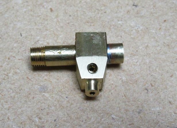

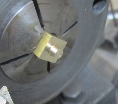

So, here we go with a new design that more closely approximates those of commercially available RC carburetors.  I started with a piece of 3/8" square brass bar chucked in the lathe and cut a round boss on the end.
Next, I drilled a 1/16" hole about 1/2" deep through the center.
Then I tapered all 4 sides of what is to become the bottom of the carburetor.  This is done partially for appearances and partially to make it easier to affix the fuel supply nipple.
Next I drilled and tapped a 6-32 hole in one side.  The fuel supply nipple will screw into this hole, which connects with the center hole drilled earlier.
Then I cross drilled a 1/4" hole which will receive the venturi tube...
Here is the venturi tube.  I started with 1/4" brass rod, drilled a 1/8" hole through the center, threaded one end with 1/4" model pipe taper threads, and used a countersink drill to open a taper for the air intake on the other end.
Then I soft soldered the venturi tube into the body.  I cleaned both parts with denatured alcohol, slathered on some plumber's flux, fixed it in the vise, placed a ring of solder around the joint, then heated it from below with my Mapp Gas torch until the solder melted and flowed into the joint.
And, here is the built up carburetor body so far...

Nifty.
How did you do the tapers?
Thanks, Carl.  I clamped the work piece in a cross slide mounted vice, set at an angle, and faced off the angle with an end mill chucked in the lathe spindle.

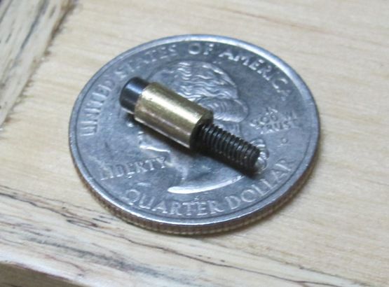

Got the needle valve finished today.  I started with a 2-56 socket head cap screw.  I needed a way to chuck it in the lathe so I could turn the taper on the end.  So, I made a threaded sleeve from a small piece of brass rod.
Then I chucked the brass sleeve in the 3 jaw chuck, set the compound to 4 degrees off the screw axis and turned the taper.  The tip is about .025" in diameter.  I finished the taper surface with 1200 grit wet or dry sandpaper.
And here's what it looks like on the engine...
I used the following procedure to make the needle valve seat.
- When I originally made the body, but before I soldered in the venturi tube, I drilled a 1/16" hole from bottom thru into the opening that later received the venturi tube.
- After I soldered the venturi tube in place.  I used a .040" drill to go in through the 1/16" hole and drill through the wall of venturi tube.  I first used a 1/16" bit to dimple the side of the venturi tube to help center the .040" bit.
- Then I pressed a 1/8" length of 1/16" brass tubing into the 1/16" hole, seating it against the outside edge of the venturi tube.  The ID of the 1/16" tubing is about .032" and will serve as the seat for the needle valve.  If the seat ever gets worn, I can just drill out the old length of tube and insert another one.
Chuck

« Reply #5 on: February 06, 2014, 02:42:15 AM »
One more set of pictures for the day.  Here you can see the 3/16" cross hole drilled that will hold the throttle barrel.
In this closeup, you can see the fuel inlet from the needle valve.
