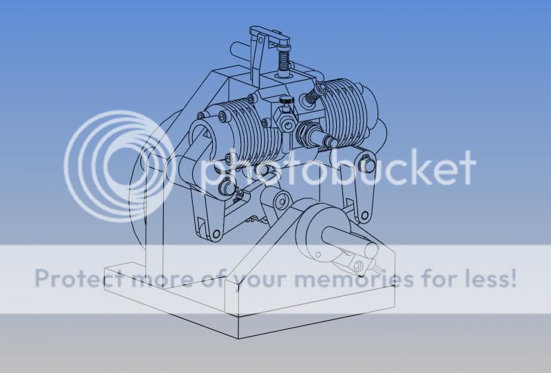

Since Brian so generously posted drawings of all the parts and had such a beautiful build thread on his engine I started building one with a few changes to suit my personal preferences, practices and tooling.
I sent Brian a photo of some parts and he said he would not "object" to me starting a thread on my build. Knowing Brian, this sounded like a direct invitation. Since his thread is so complete this will just be a more or less photo essay with notes where I did something different.
First off, Brian likes larger engines that I do so this 1/2 size of Brian's. This makes the fasteners come out a little weird in some places, but roughly 1/2 size, ie 0-80 in place of 5-40.
To get started, I have brazenly plageurized Brian's thread for a concept drawing of his engine. His engine has changed some in details as his build has progressed but this is a pretty good representation of what his and mine will look like.

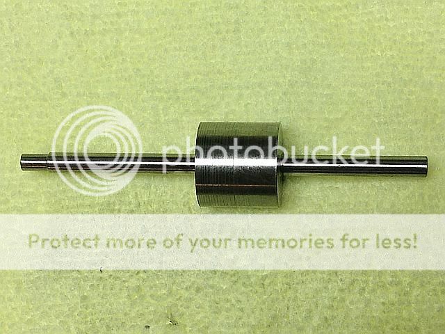

Lets get started with the crankshaft. Of course I could not leave well enough alone. Brian built his up, but in my size it is easier to turn out of the solid.
The crankshaft started life as a length of 3/4 inch diameter 1144 stress-proof  steel.  The ends were turned down to 3/16 diameter.  I added a little bit of length to the flywheel end and turned it to 4mm diameter.  This is for a one-way bearing/clutch for a built in started that I want to try. That end was drilled and tapped 2-56 to hold the bearing in place with a washer.  The starter may never happen but at least I can put it on if I want to.

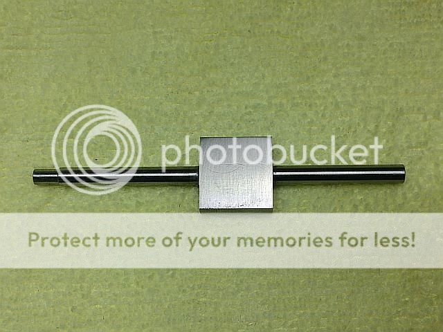

The center of the blank was milled to final thickness.

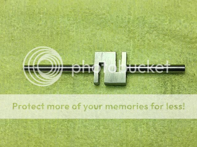

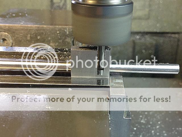

And the crank pins roughed out on the mill.

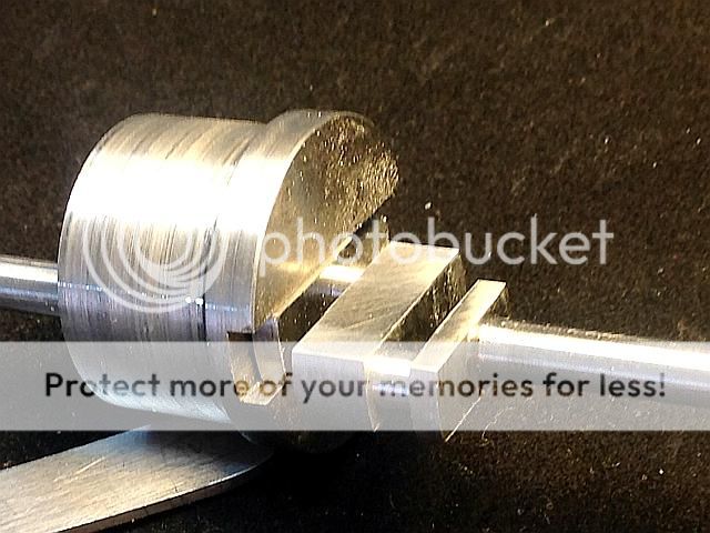

And looked like this ready to go into a turning fixture in the lathe to finish the crank pins.
Here is the finished crankshaft in the turning fixture after the pins have been turned and finished.

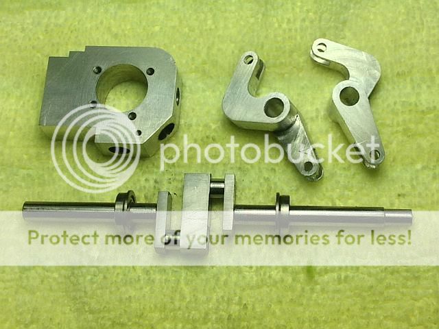

A few more parts. The rocker arms and the cylinder center block are probably the biggest pain in the rear of all the engine parts.
The cylinder center block is to Brian's drawing except 1/2 scale or course.  There will be 4 more 0-80 tapped holes to retain the valve cages eventually.  I found room for them and have them on my drawing.  I will put them in later when I detail out the retainers and am sure they are OK.
The rocker arms are to Brian's scaled print. I made them out of 2024 aluminum because it has good wear properties running on steel shafting.
The crankshaft you have already seen. Notice that there are 2 ball bearings on it. They are FR166ZZ. I prefer ball bearing to sleeve bearing.  I get my bearings from AVID R/C.
