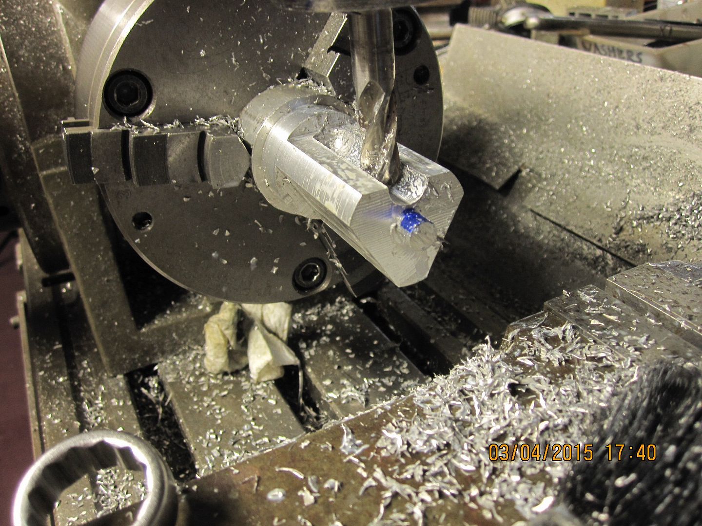

Had a go at the driveshaft for the supercharger. The drive needs to be at the rear of the engine, and up to the s/c with another belt.
The supercharger will be built in to the rear of the intake plenum.
The s/c needs a 2.6:1 speed increase over engine rpm, according to my crude calcs. I was a bit concerned about the strain on the drive system when revving the engine up fast, due to the inertia of the s/c rotors and gears, so I have put a slipping clutch into the rear timing pulley. The clutch discs are ptfe.
I wanted the preload on the clutch pack to be via a Bellville conical washer, but couldn't find anywhere to buy less than £25's worth min. order, so I decided to make one.
I used some nice spring steel strip, which are actually Almen strips we use at work to measure shot peening intensity.
These were softened, drilled, turned, pressed into a cone, hardened back up, and then tempered a bit from light straw colour.
It works fine.

I think your concern about the supercharger drive is well justified. The slipping clutch is a good precaution, but there may be a limited window between slipping and delivering the normal running torque required at higher revs. There are other methods of easing problems with supercharger drives that you have probably already considered; one is to use a long drive shaft with a small diameter, but well supported. This allows for a small degree of torsional wind-up which reduces snatch loading on fast rev changes. Another is to use a sprag clutch so that the supercharger is free to rotate in the reverse direction. This insulates it from snatch loads in the throttle snap shut situation.
The other concern with the drive is what happens in the event of a backfire of course.

Billmac, I think the clutch should be fine for this purpose. In my head I can see the difference in high speed running torque and acceleration torque to be a factor of 2 or 3 different, so hopefully there won't be any clutch slip during steady running.
I got bored with making sparkplugs, using my recently aquired Macor, (thanks again Ramon), so I decided to make a test rotor for the supercharger. The proper rotors will be 90mm long, but I just did a trial piece and cut it in half to try the mesh.
The centre distance is dictated by the already existing helical gears.
