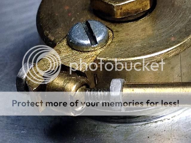

One of our members is currently building Elmer's #34, Cross Twin Engine. One of the few places that Elmer ever had a design flaw was in the valve linkage of this engine. The valve link connects two parts rotating through an substantual angle at 90 degrees to each other. With a pin at each end the link bar must bend if the pins are close fitting or if the holes are made oversize there is considerable play in the linkage at mid valve position. I did not find either method very acceptable so ball joints were made. I have since used them for several other linkages.
Here are photos of the Cross Twin Engine link ends. This engine was built over 20 years ago and my workmanship has improve some since then but you can see the problem. For size reference, the threaded sections are 0-80. In the first photo you can see the half hole remains of the original hole for the pin used in Elmer's linkage as built according to plan and then replaced.
The balls are 1/8 inch (0.125) diameter brass. They are available from most tooling suppliers but I get mine from Toolsupply on Ebay. They have been selling all kinds of ball on Ebay for many years. The 1/8 brass ball are currently US$ 6.00 per 100 with free shipping if you buy from the Ebay listing. If you buy from thier ebay store they charge an extra US$2.00 for shipping. Other places like MSC and McMaster Carr have them for US$ 7 to 8 plus shipping. I have been buying from tool supply for many years and they have always given me good service.
http://www.ebay.com/itm/380792857744?ssPageName=STRK:MEWAX:IT&_trksid=p398 4.m1423.l2649

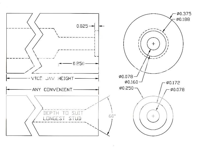

Lets start building with the drawings.
First off the parts of the ball joint. Two variations of the socket are shown on the left. One for using a drill bit to form the socket and one for using a ball end mill. Your choice. Both seem to work equally well. If you use the drill bit method, the drawing dimension are for a 118 degree point drill bit. Do not use a 135 degree point drill bit as the stud hole in the ball will be riding on the bearig surface and cause some binding.

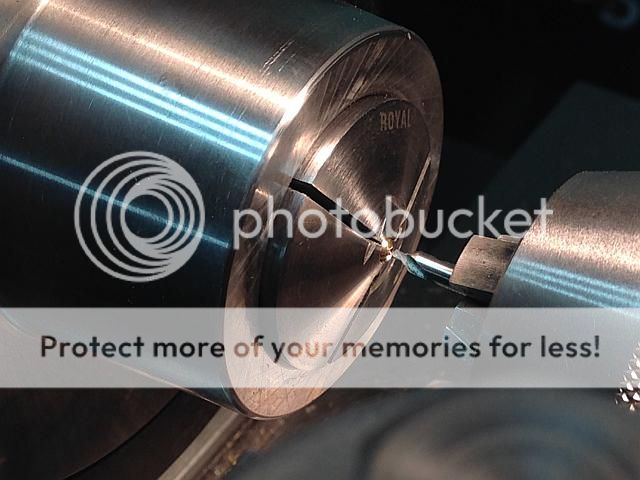

The photos show all the lathe work done in 5C collets in the lathe, but I did the originals in a drill chuck mounted on an arbor and chucked in the standard lathe chuck.

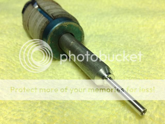

Although not essential, a stop to locate the ball makes life a lot easier. Here is the stop that I used in the 5C collet.
The tip of the stop is 0.120 inch diameter to allow clamping on the ball. The hole is 0.078 to allow clearance for the tap drill and tap when machining and should be about 3/8 deep.
If you use a drill chuck that does not have a through hole, a stop of 0.120 diameter with a 0.078 hole can be inserted in it to make a stop. With a drill chuck be careful not to tighten it too much as the jaws can deform the ball. This is not a problem when using a collet.

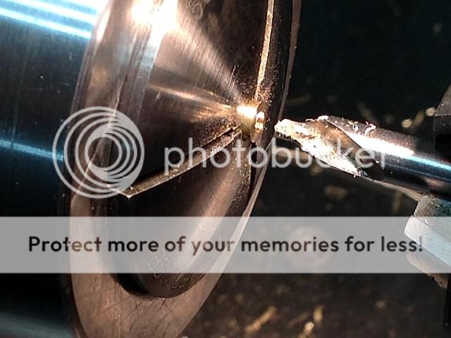

Machining the ball.

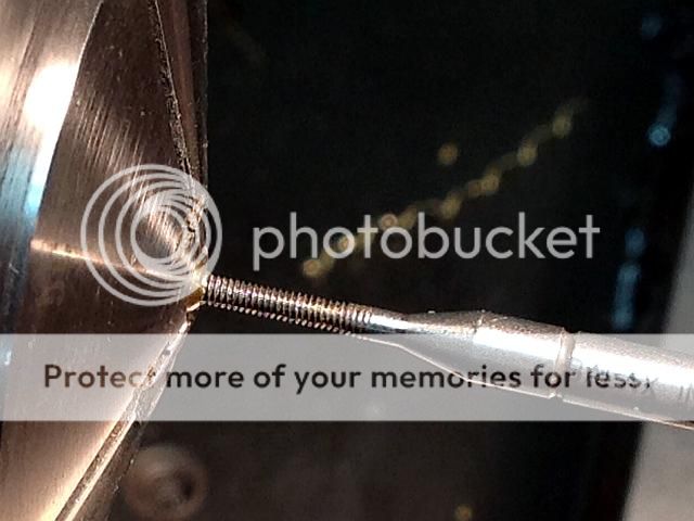

All that needs to be done to the ball is drill and tap it.
The ball is center drilled and then drilled with a tap size drill. For 0-80 threads use a #55 drill if using a cutting tap. I use thread forming taps so I drilled #54.
And then tapped.
After tapping, and before removing the ball, polish off any burrs on the ball with some abrasive paper or cloth. I uses 320 grit. If you screw a 0-80 screw into the ball to remove it, then the other side can be rubbed on the abrasive paper using the screw as a handle. Just rub enough to remove the burr as we don't want to change the ball geometry.

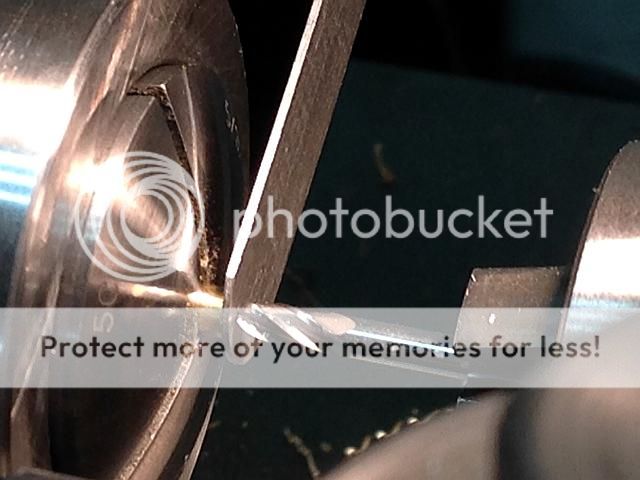

Start with some 5/32 brass 360 rod. Face off the end and center drill it.
Then either drill to depth as shown on left illustration on the first drawing or to a depth where the flute provided a full diameter for a depth of about 0.032 for extra clearance if using an 1/8 ball end mill to form the pocket. A standard ball end mill will cut slightly undersize as they are ground out of 0.125 stock and the ball is slightly undersize. If you let the end mill "idle" for a few seconds at the bottom of the cut it will probably come up to size as the tailstock will probably not be exactly on center line or from tailstock chuck runout. Or you can put a little side pressure on the tailstock chuck but this will probably not be necessary.
To set the depth of either the drill or ball end mill, use a feeler gauge to touch off the tool. I use a 6 inch machinist rule that I know to be 0.025 thick. Zero the tailstock dial and drill to drawing depth plus the thickness of the feeler.

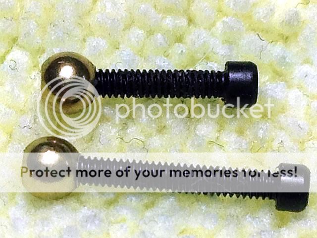

In the following photos I should have put a nut on the screws that I used to make the studs. Then after cutting off the heads the nut will clean up the burrs from cutting off. I normally do but forgot this time. Case of do as I say and not as I do.
I made the stud from 0-80 socket head cap screws. I used them as it is easy to chuck on the head to cut them off.
Screw a nut on the bolt all the way up to the head.Clean the ball and screw to remove any oils. Then use a SMALL amount of high strength Loctite, such as 640 or 680, screw the screw into the ball about 3/32 (0.09) of an inch.
After the Loctite sets up, clean the assembly up with solvent to remove and excess Loctite.

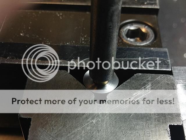

Here is the business end of the anvil and punch used for staking. They are detailed in the second drawing. Any grade of steel works fine for these. It is convenient to make the anvil length the same as the jaw height of the vice you are going to use it in.
The anvil is held with a vee block in vice. I use my milling vice. The bottom of the anvil rests on the bottom of the vice jaw slide. Here the anvil is in place with a joint socket in place with the punch next to it. Notice the gap between the edge of the socket and the ball. This will be formed around the ball with the punch.
Before putting the ball assembly in place, a small drop of oil is put into the socket. About any light oil is fine. 10 or 20 weight or 3 in 1 all will work fine.
