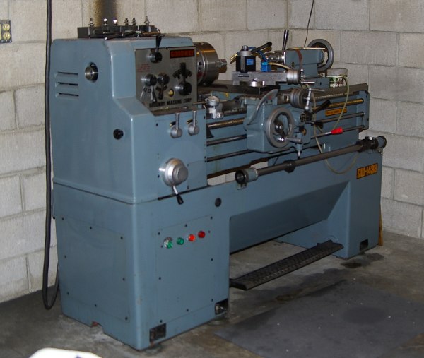

In the mid-1980s, after a couple of years at a “real” job, I realized I could afford some machine tools. So I spent all my savings on a lathe, a mill, and minimal tooling. The lathe is a 14”x33” 5HP Goodway from Taiwan which I purchased new. Compared to others here, a large lathe. I've used no other lathes to any extent, but really like this one.

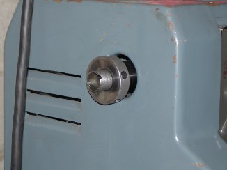

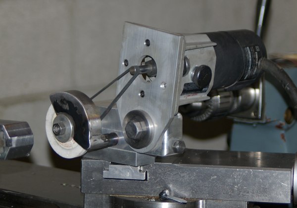

I've build a few add-ons including a tool post grinder, 5C collet holder, soft jaws, etc. One advantage of a larger lathe, with a 5MT spindle, is a 5C nearly fits inside the Morse taper. An adapter is a fairly clean addition.

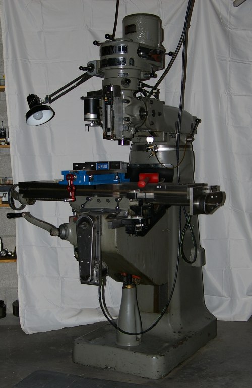

My mill is a Bridgeport size knee mill, a 2HP SuperMax also from Taiwan. I purchased this used with mechanical dial readouts on the X and Y axes.

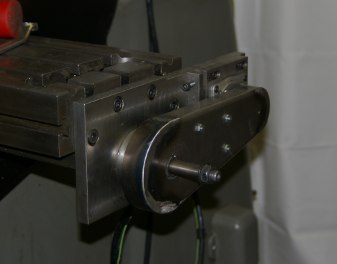

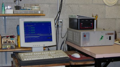

Some 15 years ago, after too much futzing with a rotary table, I initiated the adventure of retrofitting my mill for CNC. After 3 or 4 years of part time effort, I had a three axis CNC mill. I haven't used the rotary table since. I'm now using VariCAD as my CAD system and SheetCAM for generating G-code. Both run on a Linux system which is the only operating system I now use. Obviously I use LinuxCNC for the machine controller. SheetCAM is a 2 ½ D package and I'm still looking for an inexpensive 3D CAM package for Linux.

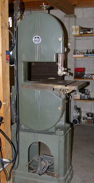

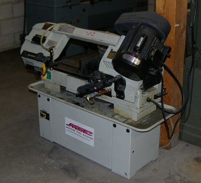

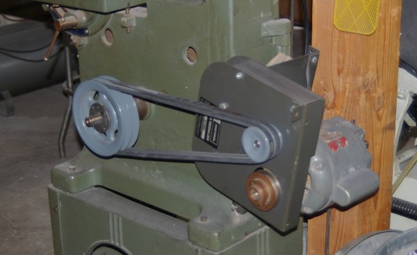

There's a 7” horizontal band saw from MSC and a very old converted vertical wood band-saw. The vertical isn't too useful but retains its place.

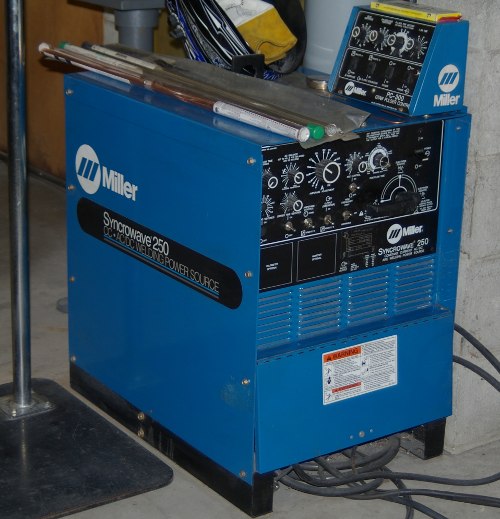

I also have a old SyncroWave 250 welder set up for TIG. TIG welders have gotten so much smaller, with improved power electronics, but this one is in place and works well. (works far better than I do.) When I purchased it, it was the smallest welder available with high frequency for aluminum.

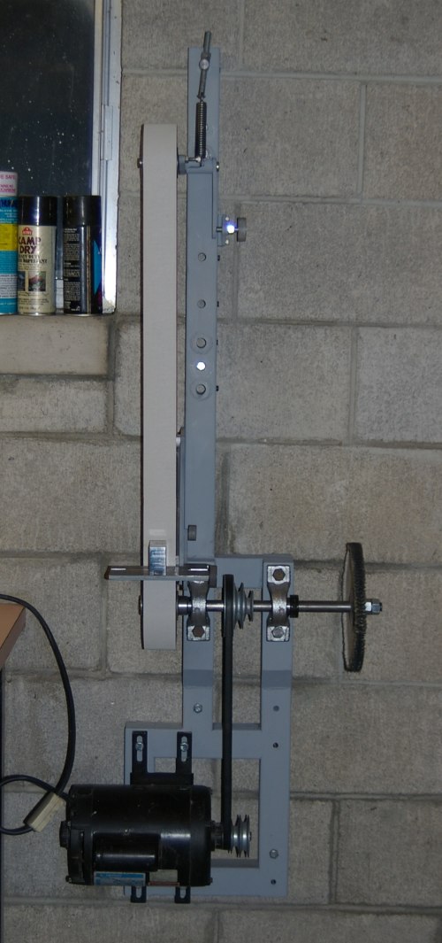

The newest addition is a stationary belt sander I built last summer.

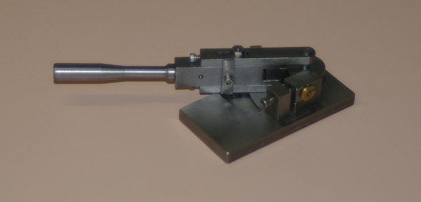

And, needing a small tube bender to fix the one shot oiler on the mill, I made one from plans. Some might recognize the plan set.

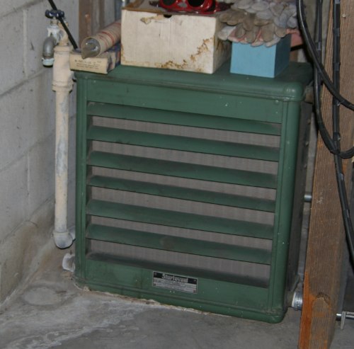

But the item which may generate the greatest envy is this radiator.
We live in a very unique neighborhood in Klamath Falls, Oregon where one can drill a hot water well. We don't pump water from the well (that's against code) but run two pipe loops down 200+ feet and back up. The water comes out at 180F. One loop for domestic hot water and one for heating. Well, the shop is plumbed into the heating loop keeping it at 68F, for free. It's really nice, forever hot showers and if the house gets stuffy just open a couple of windows and turn up the heat. (Though at -15F the shop loop struggles and the temp can drop to 60F or so, oh well.)

Very nice setup Hugh, your shop looks well equipped. Your vertical bandsaw could be more useful. I converted mine with a VFD and put a carbide blade on it and now can cut anything I want with little effort. I hope to see some of your projects posted.

Paul, I do like my mill. It's a good trade-off between space and capability. Nice to have some mass behind a cut.

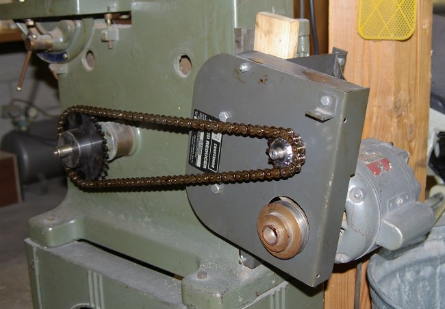

Don, the vertical band saw has a reduction box (timing belts) on it so it's running about the right speed. This was installed when I inherited it. The problem is with belts slipping on the slow speed side, driving the lower band wheel. I replaced the single V-belt with a dual but it still slips.
A VFD would be nice, but the mill gets one before the bandsaw. I think it would require a three phase motor also. This wouldn't prevent the belts from slipping. It's a low priority but would like to hear any solutions you guys have. Maybe a timing belt drive?

Hugh, one way to overcome the belt slip would be to change to poly-V belt, the motor pulley is a bit small for a V belt, although I did partially cure that on my vertical milling machine by using an automotive fan belt that has notches in the back/inside of it, that allows it to flex more, it's a B section belt, and the pulley is smaller than yours.

Thanks for the note. A poly-V would be better. After reading your note I've thought a chain drive may also work well and, I suspect, be less expensive than a poly-V drive. After all the reduction the rpm is very low, good for a chain. It eliminates the overload safety of a belt slipping though. I wonder where the next weakest point is?
I may try a chain drive, the parts aren't too expensive and locally available. If I do I'll report back.

My thanks to Don for suggesting my vertical bandsaw could be quite useful. And my thanks to Ian for suggesting something other than a V-belt. My old set in the ways mind was stuck of a V-belt drive. "It had one to start so it must be right." Ian's suggestion made me re-evaluate this assumption. It's a very slow speed, which would be great for a chain drive. Don's comment convinced me to make the change.
I was able to source the parts locally and put the drive together today. It no longer slips and cuts much better. There is more strain on the reduction system though which may have to be rebuilt down the road, if it sees a lot of use. But for now it's a great improvement. Thanks guys.

How about a chain guard - it will improve safety and chain life if done properly  :stickpoke:

I didn't mention it, but a chain guard will be added. It's on the back side of the machine, but still needs one. It'll be a simple sheet metal fabrication rather than an oil bath, it'll keep dirt and chips of the chain.
Thank you for noting this, I need all the reminders I can get.

Hugh glad to see you sorted it out. It will be a useful piece of equipment.
