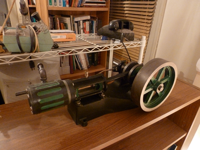

Hi Florian,
( quote from your post No 143 .
Well, there was a "wait a second" in my head. Someone (here?) told me that silicone O-rings will expand under heat. In fact, the pump could only be moved hard, with quite an amount of force.
So I stopped the whole thing, took the pump back to the shop and removed that o-ring. Instead, I made a piston packing with teflon tape. )
I mentioned the Silicone ring some time ago that it expands 100% under steam.
You have used Black Viton rings that are not suitable for steam but Pneumatics and Hydraulics, so when the steam hits them they stick.
Also the groove dimensions that you use seam too tight if you were to use Silicone "O" rings.
I must commend you on your decision to make the pump slide valve rather than to the Stuart drawing, it has much more control without the amount of steam loss in the exhaust which is a bit of a pain in a Piston valve set up hence Stuart pumps are renowned for their steam consumption.
It would appear that the "O" rings on the shuttle is a good thing but can't be fitted to the Stuart drawing as they would pass over the steam ports and tear.
I finished my Pump a few weeks ago and it performs well being self starting and can be slowed down, I left out the drain valves as the pump clears itself of condensate every time on start up, the tapped holes for the drains are there with a plugs inserted to fit valves in the future if ever needed.
Good job, well done !!!!!!!!!!
(Enclosed some pics of my completed pump)
George.
Your never too old to learn.
