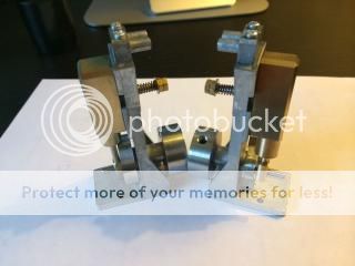

a couple of pics before I take them down for the assembly , I have made a couple of bases out of that brown stuff , but as to the paint for the engines I am going to let them decide
they both run well , yes they are simple but they will serve the purpose , I say simple the setup on the rotary table to drill the ports was not .
two ports at 17mm pcd displaced 14 Deg either side of the centre line with the shaft and the pivot
an interesting analogy Kit £20  lathe £9k mill £1.5K   150 mm rotary table say £200 and Drills and Reamers
