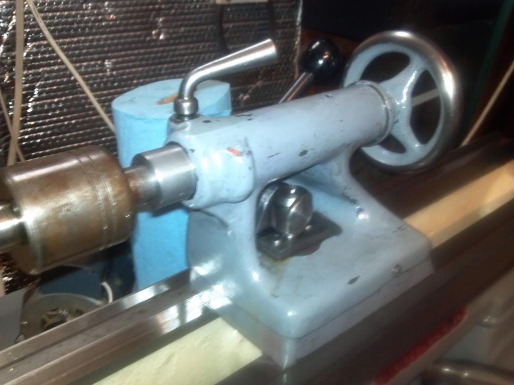

I have never felt the need for a DRO on the tailstock as it already has a rule/measurements on the barrel and a vernier on its handle.
