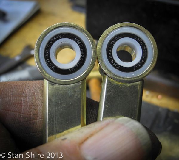

The flywheel bearing “towers” are next. I had seen these acetal bearings with stainless steel balls and though that this might be a good engine for a tryout. They are described as “no lube” if run under 2500 rpm. Maybe.
The primary problem is that they are wider than the .5” x .5” brass square. Even though there appears to be plenty of room for a wider piece, I had another idea. And I’m not in love with straight square pieces.
That looks like it might fit.
A bit of drilling and boring got me just under what I need. The engineering data for the acetal bearings gives from 0 to -.003” interference. The bearing O.D. is .625.
I’m going to line bore the last 1 or 2 thou when the blocks are mounted on the baseplate. For now, the bearing almost presses in.
Good enough for now so I parted off two pieces.
I wasn’t overly concerned with the internal finish as that will go away when they are bored to size.
For the bottom of the bearing tower, I rounded off the corners of the .5” square bar.
The two pieces are roughly to length. The action then moves to the mill to make both the same length and to mill a recess for the round bearing shells.
Ready for their debut on the soldering stage.

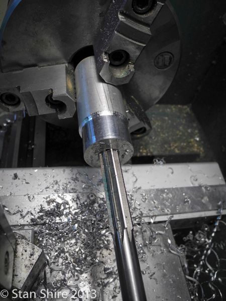

The cylinders ride on the rotary valve. In my 2X version, they start with a 6” brass square bar - 1”x1”.
Off to the bandsaw to cut the piece in half.
Once again, I had to dismount the 5C chuck. The largest square, 5C collet is .75”. The brass is 1”x1”.
Mounted the 4-jaw and clocked the piece in. My plan is to turn the round sections and drill and ream the cylinders for the pistons. At that point, the round part will fit in a 5C collet and I’ll change back to that.
Turned to somewhere near .95” but not a critical dimension as it’s the outside of the cylinder.
If I’m not turning into a shoulder, I would use the tangential toolholder with a round toolbit. This gives a beautiful finish. The finish is not so beautiful here but a bit of fettling (I was dying to get that in) and Scotchbite made it acceptable.
Drilling and reaming the cylinder bore, repeat the whole process for the other cylinder and that finishes the 4-jaw.
Moving to the mill to drill and ream the .5” hole for the rotary valve.
A nice slip fit. Repeat for the other cylinder.

Next, two aluminum spacers, 1.25” diameter. These slip on the rotary valve between the valve block and the cylinders.
After drilling and reaming to .501”, both spacers are parted off.
Since the bearing towers are .5” wide and the bearings are .25” wide, I needed a filler to take up the space. I turned these to .001” over the I.D. of the ring. The center hole is .015” oversize so there isn’t any chance of interference with the shaft. When I looked at this picture, I realized that I need to do more fettling to blend the ring with the base.

The housing, flipped over with the bearing ready to go under the press. Anxious to see how these acetal bearings work out. They are supposed to be “No-lube” under 2500 RPM.
Two more for the “finished” box.
