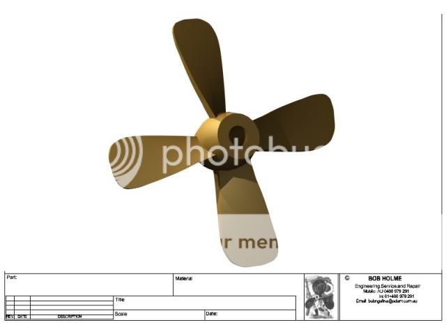

I made a CAd drawing of this

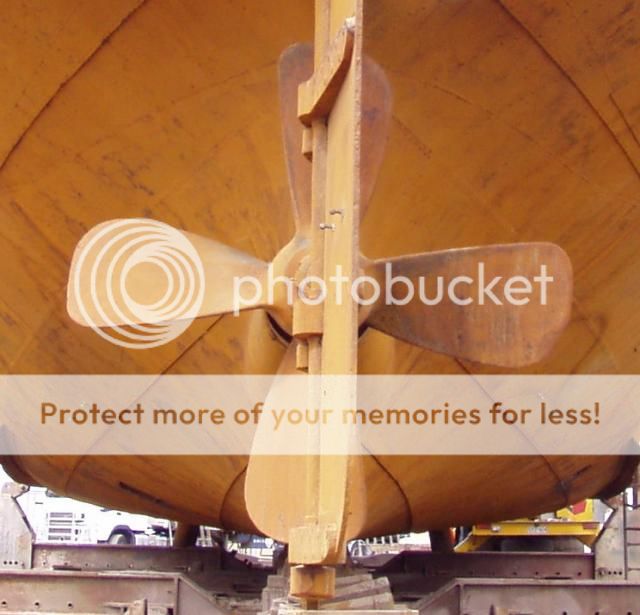

from this photograph
I did know the basic propeller geometry such as Diameter and Pitch and I traced the blade shape into CAD which by scaling gave me a very close projected outline of one blade and from there after a lot of help from forum members such as Ausdier and Jo a propeller was re-born.
