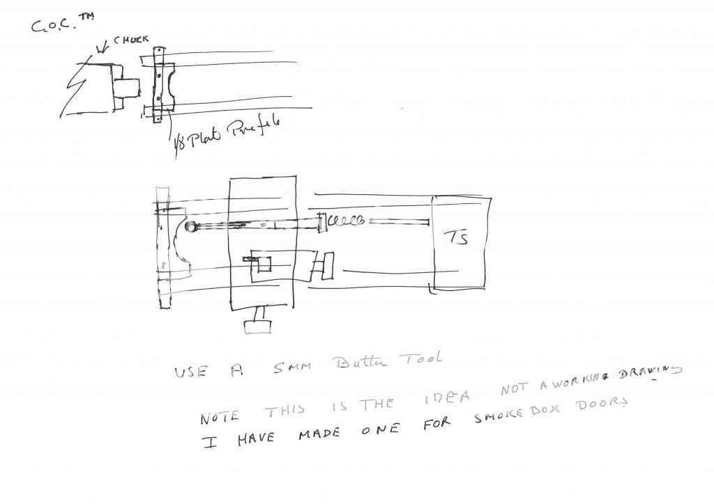

Why not make a tracing tool for your lathe I made one for my Myford
You need a profile clamped to the bed ,a roller to run on it , a car valve spring to hold the carage on to the profile
Apply the cut with the compound , and wind the feed in
I will do a crap o cad for you later when the del man has been ( I blame you for this no snap for me next month ) one of those cog tool posts do dahs , hope it ok as it's not a new one
I might have exactly that little gadget  :embarassed:, I was planning to use it on the tee bar handles for the UPT  :naughty:
It is a bit small to fit on the Colchester  :Jester:

Then make a bigger one

« Reply #203 on: April 10, 2014, 03:28:42 PM »
for what its worth
