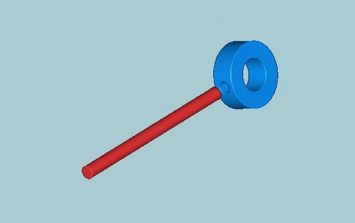

I'm playing catch-up with the posting, so onto another part! The valve rods are the last part of the valve linkage that needs doing. I used 5/32" precision ground stainless, but the rods have a ring on the end that needs to be machined, so I had to silver-solder on some lumps of 1144SP.
A small step was turned on the ends of the rods to fit into a short 1/8" hole in the blocks, and they were fluxed and set up with a solder ring (56% silver) and a few small bits of solder at the bottom of the holes.
In hindsight, this wasn't the best setup; the boiling flux pushed the rods out of the holes, and they had to be pushed down. A small cross hole would have been a good idea (but would have required boring, rather than drilling the cross hole later).
But with some twisting of the rods while the solder was liquid (which was necessary to wet the stainless) I got two mostly good joints:
After cleaning off the flux, these went into a square collet block to square up the end lump relative to the rod with some gentle cuts:
leaving me with this:
Now I could hold the blocks in the vise to drill the cross hole:
However, when drilling I could feel the drill wandering, because of the inside hole and the harder silver-solder, so the hole was opened out to reaming size with the tiny boring bar:
then reamed.
Now I can flip the part around to hold in a collet to turn the outer end down to 1/8" with a center:
before threading the central section 3BA:
Even though the core diameter of 3BA is a hair over 1/8", the die marked up the 1/8" section which was somewhat annoying, so that had to be smoothed out again. Yet another reason why I should learn to do single-point threading!  :embarassed:
One thing I've found with this 5/32" SS rod is that, despite being "precision ground", it's actually about a thou oversize (I suspect so they can also sell it as 4mm) so I had to take it down with emery paper to fit the glands:

Very nice parts. Your work is meticulous and inspiring. Thank you for posting the build and in the detail you've included.
I'm curious though. Back when you built the conrods you started with round stock and used a bandsaw to get rectangular parts. I remember this because I thought if I tried this my saw would wander enough to ruin the parts. But on these valve rods you silver soldered square stock to the stainless rods, and then made them round using a rotary table. I thought you could have made the round end and silver soldered it to the ground rod.
Are these choices due to stock on hand or is there more to it?
Hi Hugh, thanks for the nice comments!
The reason I didn't make the ring first and just solder it on is that I wasn't able to guarantee accuracy that way. For me at least, things always move around during silver soldering, especially since you need a solder gap, so I tend to view silver soldering as a way to build up a bigger lump of metal that will be machined as one piece later.
Of course there are alternatives, building jigs etc to keep things aligned, but then you risk the solder sticking to the jig. At least for this case, my way seemed to turn out OK :)
Simon
