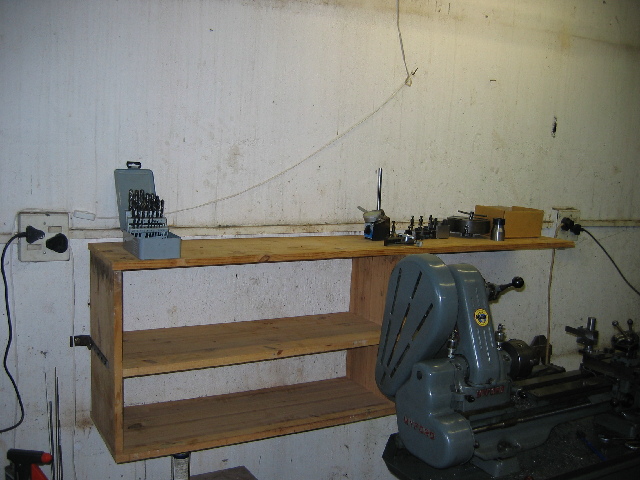

As mentioned, I'm really running out of workspace and storage space in the shop - Here is what things looked like last Monday - hold on to your chairs; it's really ugly.  It's surprising that I've been getting anything done in there and it was time to sort it out:
With the chaos, there was a limited amount of space to move around, so I started by clearing out a strip at the far side of the shop, and got the T+C grinder off the trolley it was standing on; it does have wheels, but they are small and not suited to long distances of movement.  This was the easiest part of the shop operations for the week... I'd already removed the straps I'd used to lift the machine in this photo:
I went on a shopping spree as well.  I'd saved up a bit of money for the shop revamp, but material is horribly expensive here in Namibia as it's all imported.  I must admit I really envy seeing other people's shops with lots of fine wooden cabinets and drawers.  If I could do that, it would be horribly expensive, but with a limited budget I had to spend on practicality rather than looks. So, I made a couple of salesmen happy at various suppliers, buying in a couple of lengths of heavy duty angle iron, a length of counter top as well as a handful of sheets of pressed-wood planks and some hard-board, and a bunch of electrical stuff.  The timber supplier was the first to deliver:
After receiving the angle iron, I broke out the big angle grinder to start cutting things up after some careful calculations to get the most from the material.  I'd have preferred to use the bandsaw for this, but it's stuck in it's place in the shop, and there was no way I could get the material to it to saw up.  Maybe I'm just a wimp, but using the big grinder is hard and potentially very dangerous work, so I steer clear of it unless I have to use it like here...:
Next there followed a lot of welding.  Inside the shop.  I was working alone, so carrying heavy bits of steel around didn't seem like much fun, so I made things as close as possible to final location:
I'd also drilled and counter-sunk holes int it to fasten the counter top on.
I slapped some paint on it with a brush...  I don't like painting, but one must do what needs dictate:
 :facepalm2: Unfortunately I welded the middle leg to the wrong side and I only saw that after painting :Lol:.  That meant I had to carry the lot out of the shop, turn it around and carry it back in after the paint dried.
Finally, it was in place and fitted with the counter top.  Like I said, I'm a wimp, and a 3600x600x30mm  counter top is damn heavy to handle alone!  One NEVER have enough plugs (outlets for the US folk), and that's one area I didn't scrimp at.  I added four additional 2-way outlets; three above the new workbench, and one close to where the T+C grinder and compressor will stand.  Rather than connect these new plugs to the existing plug circuit, I added a new circuit for them to the distribution board on a separate circuit breaker.  I like a lot of light in my workspace, and added two more 6' lights - one suspended from the rafters at a position where it would add suitable lighting to the "dark" side of my mill that's been irritating me, for the position the small lathe would occupy on the new bench, as well as minimize shadows while I work on the machines.  Here things are partly done; the suspended light is in place and all the work on the plugs complete:
The new lights didn't need a new circuit, so I set about wiring them into the existing one, so that all the shop lighting would work off one switch.  That caused me to discover a horror...  The wiring to the existing lights were done in a very shoddy way.  After closer investigation, I even found that the moron who did it used earth coded wires as live wires  :zap: :
The wiring as it was at the side-entrance door light switch - it's wired together with one between the two roll-up doors so that either can switch the lighting:
 :hellno: Wrong wire colour, an exposed section of live wire at one connector, and a sand dune! - I ended up going through ALL of the electrical points in the shop, stringing additional properly coded wire where needed and checked and fixed all connections not only to local code, but to my own higher standard and cleaning out the dunes.  I might be untidy in general, but when it comes to wiring and cabling I'm a royal pain in the @ss about doing a neat and proper job - as has been often told me by apprentices  :Lol: .
Sorting out the shop electrics took quite a while - time I hadn't budgeted on spending, but at least I now know I won't have issues with this in future.
After sorting out the electrical issues, I added a storage shelf above the new workbench, in a position where I wouldn't bump my noggin against it all the time while working there, but low enough to reach without a ladder.  I plonked the small lathe down in it's approximate mounting position as well:
That's where I stopped photos for a while; it shows about a sixth of the shop sorted.
