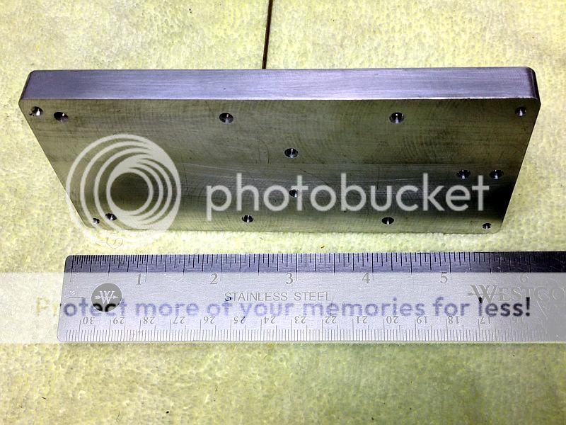

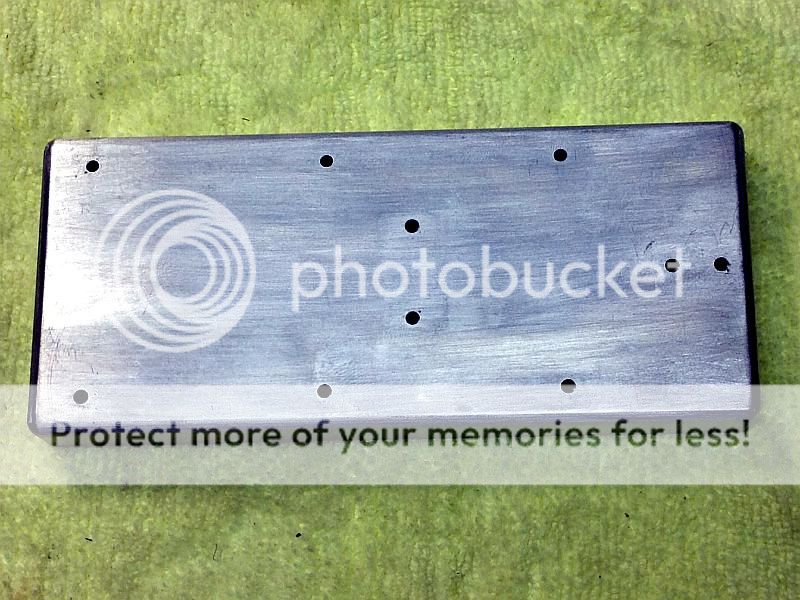

With a couple of parts made, it's time to start making some parts to tie them to gather and build upwards.
The base is just a piece of 0.50 aluminum that is squared up to 5.562 xy 2.437 inches.  The corners are rounded and the top edges got an 1/8 inch radius on them just for looks.  From the bottom, the holes for mounting all the parts were drilled and counter bored for 2-56 socket head cap screws.  The 4 corners were drilled and tapped 2-56 x 0.375 deep to mount the base to the stand when complete.

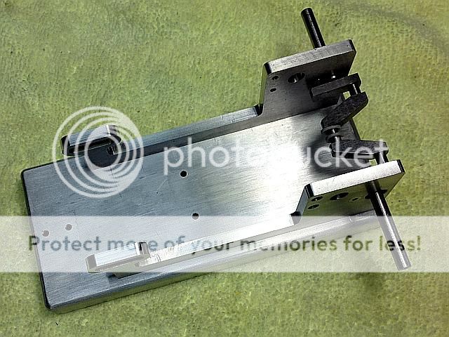

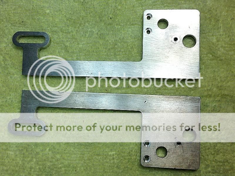

The side frames are made from 0.188  6061 aluminum plate.  They were contoured on the CNC mill.  They could just as well be done on a manual milling machine, but I probably would have simplified the shape.
The two frame sides are mirror image of each other except for the 2-56 tapped hole that is sort of between the two large holes at the right end.  The hole on the bottom one is to secure the hall effect device holder for the ignition system and the hole on the top one is the mount for the idler gear to drive the cam shaft.  If you look closely that that hole in the photo you can see that it is in a plug that is inserted in the frame.  I put hole in the wrong position by 0.020 inch when I made the part, so I put a 0.250 diameter plug in to cover up the hole and put a new hole in the plug.
The largest thole is for the crankshaft bearing and the next largest hole is for the cam shaft bearing.  Thew two counter bored  holes are for the mounting screws for the tappet mounting plate that also acts as a spreader for the frames.
On the left is 0.189 wide slot.  This is a slightly loose fit on a 3/16 (0.1875) OD ball bearing which rolls in the slot to act as a crosshead for driving the opposing piston that is away lfrom the crankshaft.  Demands on the crosshead are not very criltical because the connecting rod is so long that it only has a max angle of less than 4 degrees.
In the bottom flat edge, not visible in photo, are three 2-56 tapped holes to mount to the base.

Now I do a little bit of assembly work to start getting a look and feel of how things are going to look.  I made up two PTFE (Teflon) washers 0.25 OD x 0.16 ID and about 0.03 thick.  Split them with a sharp knife at installed them on the center throw of the crankshaft by twisting them open to slide over the crankpin. The center connecting rod will install between these washers and they will keep the rod from touching the crankwebs.  It should not anyway, but a little extra safety margin does not hurt.
A 3/16 (0.1875) x 5/16 (0.3125) flanged bearing was slid over each end of the crankshaft.  I had left a little radius between the shaft and the crankweb when I turned the crankshaft so the bearingdoes not quite seat against the crankweb.  If I had not left the radius I would have made up a thin washer in installed it so the crank web could not rub against the outer race of the bearing or have turned a small shoulder for the bearing to seat against.

One of the frame sides is mounted to the base.  The crankshaft with bearing is inserted into the frame side and the other frame side is slid on and fastened to the base. Everything else should be able to be inserted between the sides with them mounted.
Now it looks like I might actually be building an engine.

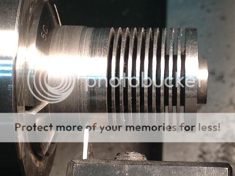

The cylinders are made from cast iron.  I use standard one inch nominal bar stock from the metal suppliers.  It is often sold as Class 40 or grade 40.  Nothing really special about it.  As purchased it measures about 1.05 diameter to allow cleanup to the nominal size, which I do so it will fit into a one inch collet.
A stud 0.437 diameter is turned on the end that will locate it in the cylinder mount and hold the o-ring seal that keeps the good things than make power in the cylinder.  Enough of the bar is turned down to the finished cylinder diameter of 0.984 to make one cylinder. Then the fins are cut with 1mm thickness and 1mm spaces.  Each end has s thicker section to support the mounting bolts and threads.
Photo shows the blank ready for cutoff. Then the second cylinder was cut the same way.

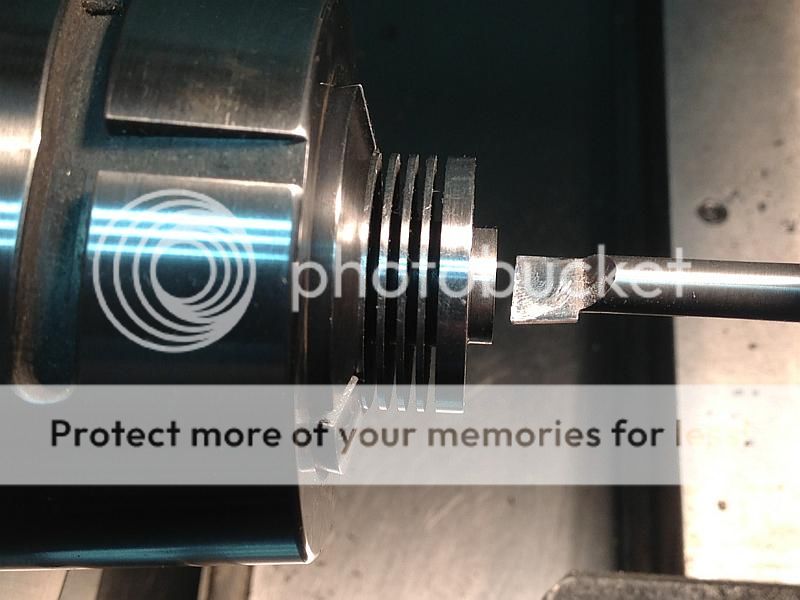

Changing collets, the cylinder blanks were center drilled, drilled and bored to 0.3735 or so to leave about 0.0015 to 0.0010 stock left for lapping.  The acutal size is not really critical, but targeting a dimension like this lets me use an old carbide end mill shank as a plug gauge.  They are typically 0.0001 to 0.0002 inch undersize. I will explain why this is nice when I get into lapping the cylinders.

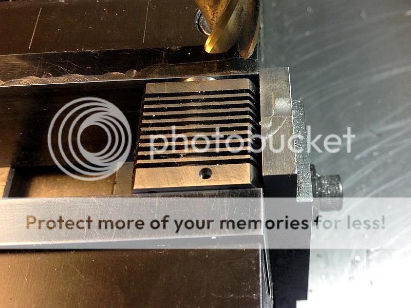

One side of each cylinder has a flat milled. The valves are located in this flat area on the inboard cylinder and the spark plug in the outboard side. The oil holes are drilled into the cylinder bores and then opened up to fit the oil cups. This defines the inboard and outboard cylinders as the holes are in different locations.
