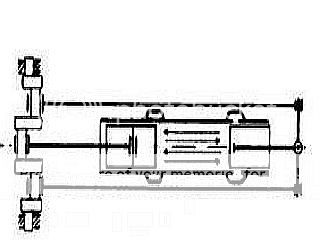

Here is one of the drawings that started it all.
Looking at the drawing you cn see the exhaust and intake ports on the sides of the cylinders. The only thing I really copied from this drawing is the general arrangement of the crankhaft and pistons.

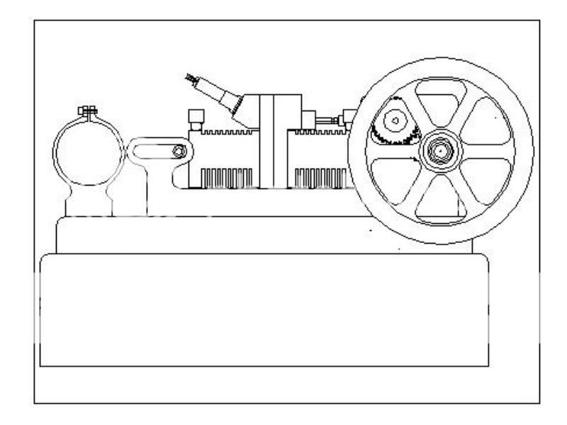

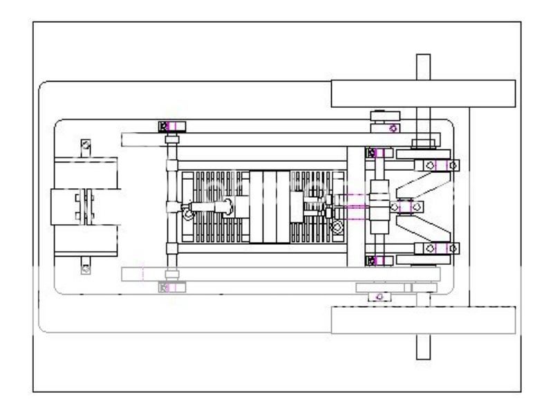

And a couple of general arrangement drawings to get started with.
The side connecting rods are not shown on the side view.  Many other details are not shown.  Some of them have not been designed.
Basic specifications are:
Bore 0.375 inch
Stroke 0.500 inch
Base 6 inches long
Gail in NM

Why were opposed piston engines developed?  In this configuration there were two primary reasons.
 1. As a two stroke the cylinder could become one piece for both pistons thus getting rid of the weight and bulk of a cylinder head.  In this model that reason goes away as a cylinder head was necessary to house the valves necessary for 4 stroke. There are ways around this but as I drew them I did not fand one that I liked.
2. With the long side rod configuration, the crankshaft had less bending loads on it.  On the power stroke as the near piston was pushing on the crankshaft the far piston was pulling on it. so So more f a torque reaction was generated and less bending.  Many more modern opposed piston engines used 2 crankshafts that are coupled  by chains, gears or some other mechanical means.  The Deltic design engines use 3 crankshafts in a triangular arrangement with each crankshaft driving 1/2 of each of 2 wo banks of cylinders. I thought about 2 crankshafts but this arrangement has more visible "monkey motion" which should make it more fun to watch.
While the advantages of two stroke operation are evident, some means of primary compression to get fresh air into the cylinder is needed.  Some of Junkers' designs used
air pump cylinders on each side of the power cylinder.  The pumps had seals on both ends of the cylinder with a piston rod extending from each from each end. They served as a cross head  to drive a yoke connected to the far piston. Later multi cylinders ones used a variety of blowers for primary compression, just as some modern non-opposed two stroke diesels do.

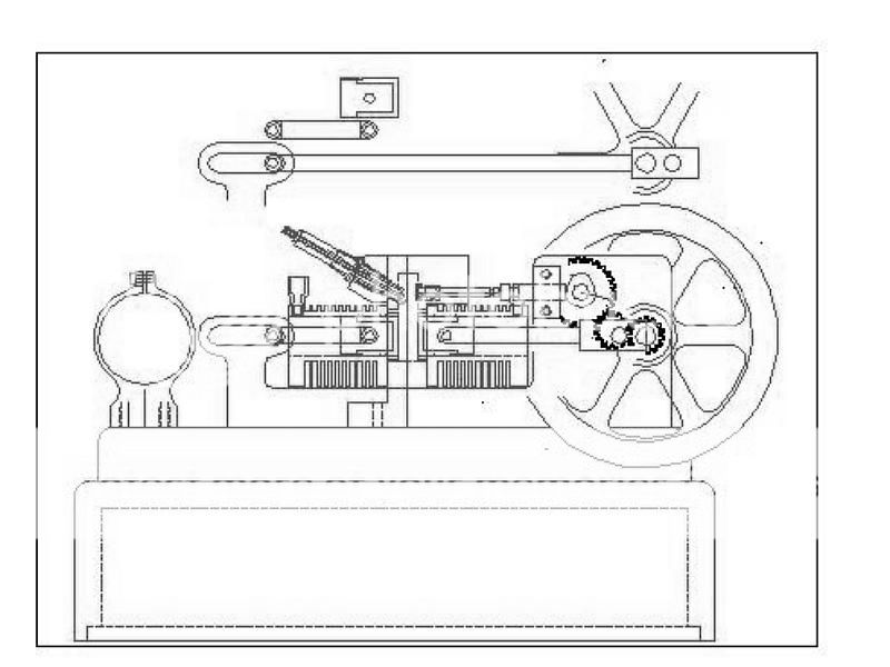

« Reply #11 on: September 07, 2013, 08:58:33 PM »
Jo: I will watch for another solution.  I know Arnold from another life.  He is not only very nice but also very talented.
Nick: Engine wise, it is hard to come up with anything that has not been tried before. Many ideas were never developes as there were other ways of doing things that were better. Still the make for interesting models.  I once thought I had invented a new steam engine valve gear.  My name will go down in history.  Turned out to have been invented in the 19th century.  Twice, under two different names that I had never heard of and I have several books on nothing but valve gear developments.
But enough of me getting side tracked.  Here is a sort of cut away view so the relation ship of some of the working parts can be seen.  The bottom end is like that of a side valve utility engine.  15 tooth Crankshaft gear drives an idler gear, also 15 tooth, which drives the 30 tooth gear on the camshaft. The gears are 48 DP with 14.5 degree pressure angle. Nothing magic about this. I just happen to have a full set of cutters for this combination. The cams drive tappets that have an adjustment to take up backlash in the valves.  Not shown on the drawing are the valve springs that close the valves.  The valves operate on directly on seats cut into the aluminum combustion chamber pocket between the cylinders.   The tip of the spark plug is in the other side of the pocket. The auxiliary view shows how the long connecting rod operates the opposing piston through a rod operating in a crosshead with a short connecting rod.  The crosshead is two 3/16 inch wide slots in the frame sides with3/32 x 3/16 ball bearings in the slot.
