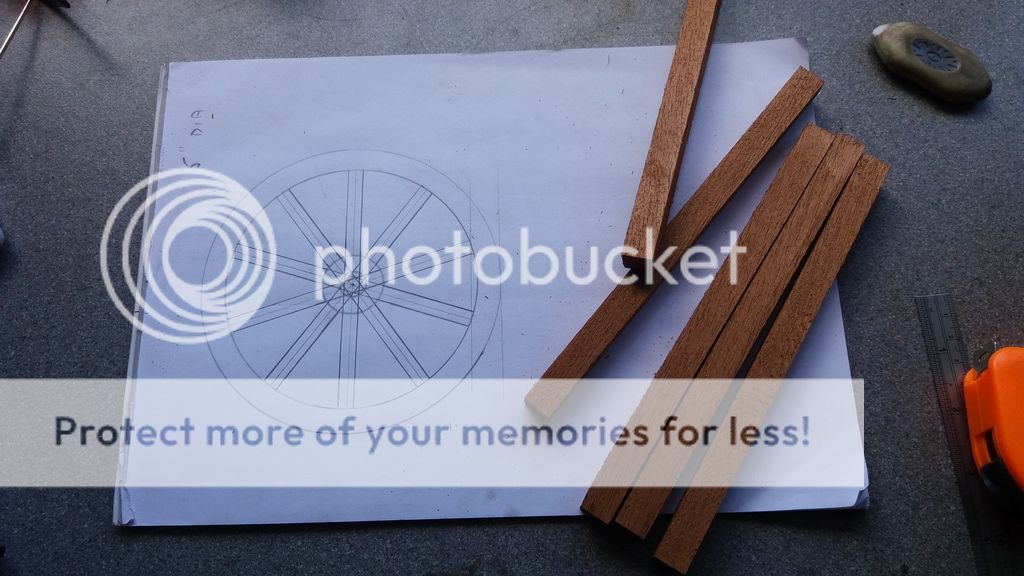

Its been a while since I posted anything cos it is the season of DIY :( So much to do leaves little shop time. For the odd half hour I can swing here and there I have started on something that I can leave and go back to when time permits. I fancy wood wheels on the engine so thats what I'm having a go at. Never done this before but I have watched a bit of you tube and looked at a few web sites. These wheels will not be fuctional more cosmetic so I can cut a few corners.
Starting with a sketch for the larger rear wheels
Followed by preparing some wood, mahogany, to 1/2" square

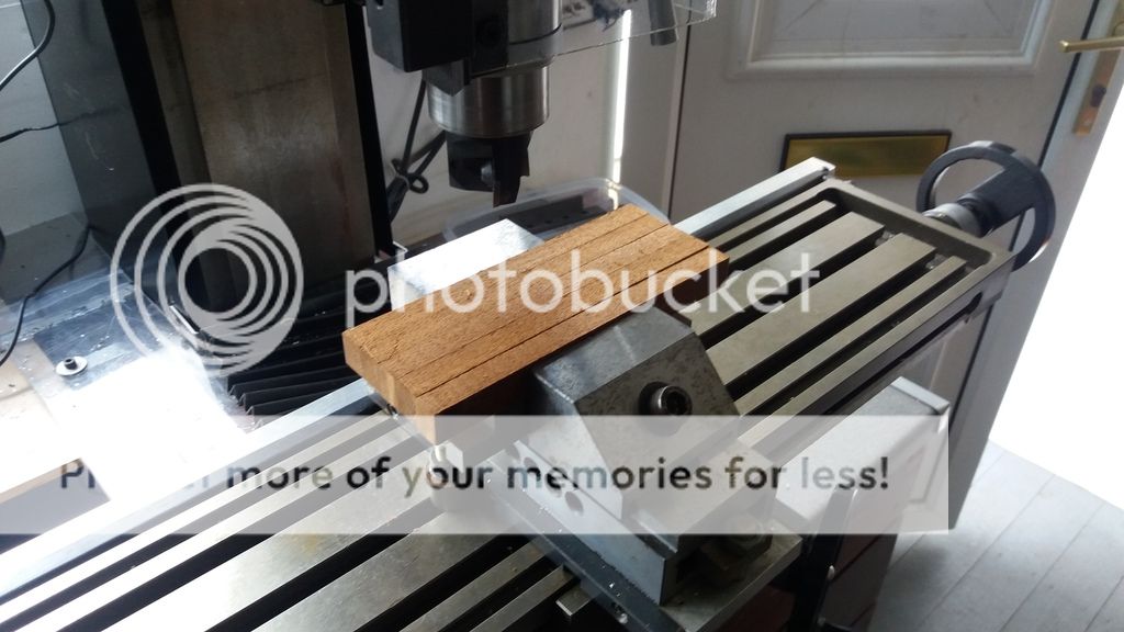

This is for the rim. I need to cut 10 pieces with their ends cut to 18°. You can see on the drawing at about the 2 o/c position where I have marked out the piece each side of one of the spokes. The mahogany is a nice wood, knot free and rairly straight grained but it does fluff a bit so might not be suitable for this type of work. It will do to practice with. I have some oak that might be better.

Rich the plecking (fluff) is most likely due to the angle of the tool if you used that insert tool to prep the wood, think of the angle of a plane iron and its far flatter so cuts rather that tears the wood. Also these inserts are not as sharp as the carbide you find on a router bit so again will tear the wood.
When you come to turn the rim use a tool with high top rake, one of the CCGT type tips would be a good bet or grind up some HSS.

Hi
Thanks Mal and Jason
Whoooooooooa scrap that plan, that won't work  :facepalm:
What we have to do is cut out the curved bits of the rim  :thinking:
Mark out a bit of wood with a compass making sure the grain runs across
Cut out with a jigsaw
Chop out 10 bits
Thats the way I think. I know its a bit rough, this is just a practice piece. I need to figure out some kind of jig that will more accurately cut the pieces.
cheers
Rich
  • Posts: 9495
Re: A portable steam engine
« Reply #215 on: May 18, 2016, 08:36:13 PM »
Rich the straight method will work fine and is a lot easier to cut the mitres, maybe just use slightly wider strips to make it easier.
If you google "segmented turning" or "segmental turning" you will see they are almost all done with straight bits of wood
