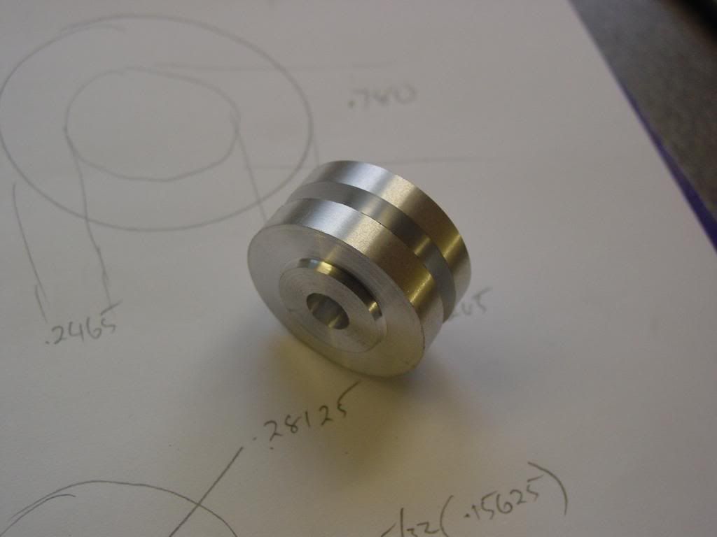

I'm not happy with the mock up of the cylinder cover so today I decided to have another go at it but this time make it in one piece. Again I have used some ally as a practice piece.
First of all the blank was turned to size then had a groove machined with the parting tool.
Faced and a small boss turned.
Then part off.

Overall much better than previous attempts. It looks better and I now know I can machine it from the solid.

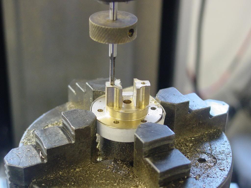

So back to the drawing board, well lathe and start again. This time I am fabricating it from 2 parts.
Start by turning, facing and drilling and reaming.
Then using an end mill to bore for the gland. I needn't have bothered doing this op right now as I will be machining it away.
Part off
Set up and centred in the rotary table on the mill. Machine a 1/4" slot.
Followed by a little shaping.
Drill 6 stud holes.
Drill and tap 2 holes for the gland studs.

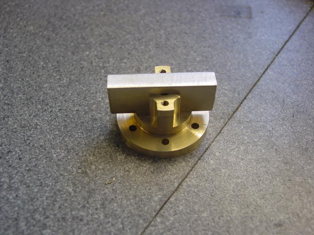

Cut a piece of 1/4" brass bar.
set up in the brazing hearth, flux and add a couple of pieces of silver solder.
After siver soldering.
Its in the pickle now for a clean up. It looks a lot better than the previous version. Next job, when time permits is to put it back in the lathe and machine the face flush again and drill and reamer.
