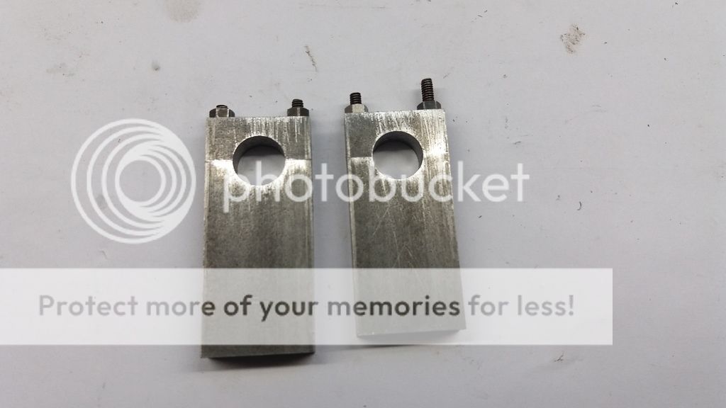

I had a few hours on it today. I'm not happy with the crank support so have started on a new one. Its built in a similar fashion to the first one. I want to have the eccentric inboard.
First turn a spacer 2.25" long drill and tap 6mm each end
The new uprights are thicker, 5/16 compared to 1/4 on the old ones. I have gone with bronze bushes instead of bearings as well. the spacer fitted to hold things square
Clamped to the new saddle
In the brazing hearth with flux and silver solder
After brazing
A trial fit
Compared to the first one
Theres still a lot of work to do but it looks better
Rich

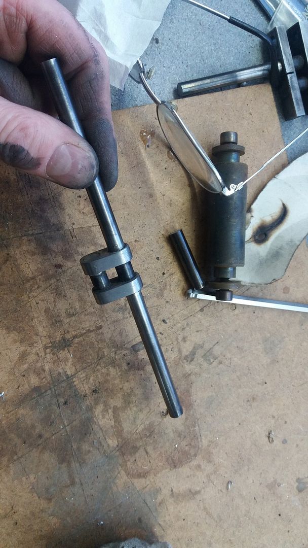

The new crankshaft.
2 pieces of 1/2"  X  1/4" flat steel. Drill through the 2 parts together 5mm. Tap the longer part 6mm and drill the shorter part 6mm. Bolt the 2 pieces together with a short bolt.
In the mill vise square to the table, use a parrallel to make sure the part is level and accurately find the centre with a wiggler. Centre drill 2 holes 1/2" apart
Drill 7.8mm then ream 8mm. Slightly counter sink the outside of each piece to give a recess for the silver solder to flow into
A 3/8" wide spacer is turned and drilled 6mm. A piece of 3/8" flat bar is also used. 8mm round steel bar is used for the crankshaft and crank pin, the crank pin is 7/8" long. The steel bar I use is salvaged. It is the rear tailgate stays from hatchback cars. The steel is beautifully ground, bang on 8mm and slightly hard but not too hard to work. Assembled and in the brazing hearth flux is applied and one side silver soldered
Allow the part to cool naturally then clean up the other side with a wire brush and emery and solder that side. I have tried building cranks before by soldering but not got on very well. Too much silver solder getting through to the crank pin which is extremely difficult to remove. Before I only had my propane torch which heats the whole thing before the solder flows but I now have this bit of kit.
Much hotter and more precise I was able to heat just the one side very quickly. Then the other side was soldered. Careful to use just a small amount of solder barely anything came through to the crank pin
After cutting off the waste
By mounting in the lathe and rocking the chuck back and forth one side was machined to shape
The other side was filed to shape then polished with emery
The last bit of waste cut out
A trial fit of the crankshaft
A mock up on the engine
Rich

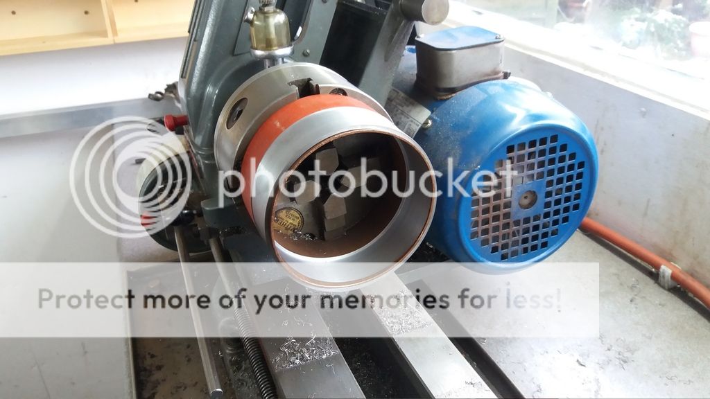

I'm still not happy with the crank support, it just doesn't sit right  :ShakeHead: :disappointed:
Maybe I'm just getting too fussy in my old age  :old:
The saddle part that I rolled from some flat bar must have a very slight twist in it. The engine runs and the support looks ok but I'm just not happy with it.

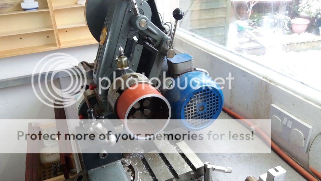

So in the lathe with a bit of steel tube
Turn the outside
Then the inside
Until an offcut from the copper boiler tube fits inside
Note the first snow of this winter outside my window
Make a couple of new crank supports. Very similar to the previous ones except I have just bored through 1/2" this time. I am going to make some bronze bushes from square stock that should look nicer.
