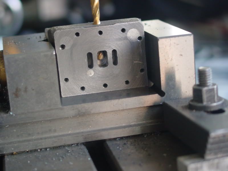

A bit of progress on the cylinder today. With the help of Sandy C the ports have been worked out.
I wasn't over confident for some reason so decide to have a practice on a bit of scrap steel.
Its a good job I did. The first attempt on the right of the picture was a complete cock up. I had all my moves worked out on paper but obviously got it wrong :embarassed: :embarassed:
The second attempt, on the left of the picture, was ok, I got it right. :) :)
The finished ports came out pretty well on size using a 3/32 and a 3/16 end mill with light cuts at maximum speed on my X1 mill. I was going to use slightly smaller cutters first then open out to size but decided to go straight in with the 3/32 and 3/16.
The cylinder set up and centred in the mill with the 3/16 cutter ready.
The exhaust port cut and the first inlet port finished.
The second inlet port cut. I have used the 3/32 cutter to square of the corners of the exhast port.
The cylinder turned sideways and cross drilled 4mm
Then drilled and tapped  1/4 X 40
A test fit of a spare brass adapter. (not the one I will use)
A pocket is machined into the ends of the cylinder 3/32 X 5/16 using a 3/32 end mill
The mandrel I made earlier is used to hold the cylinder and set it up at an angle.
Then 2 X 3/32 holes are drilled from each pocket into the inlet ports.
You can just see the holes in the top port.
