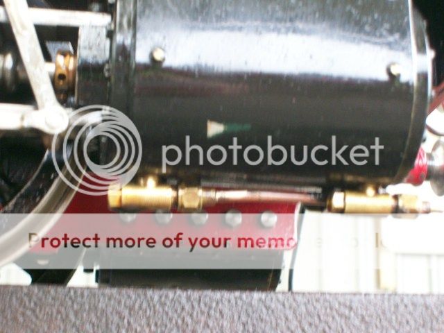

I've seen quite a few different design of cylinder drain coxs, some are operated by rods and links from the cab, some are steam activated and others are automatic.
One of the guys at the club has automatic drain cox fitted to his loco to a design that was passed onto him from another member he desribed them as having balls that open when they need to:- when water is in the cylinder, they don't have springs. I've tried to puzzle out how they work, I've not been able to ? said member and get a drawing off him he's been absent for a couple of months, hopfully he's OK.
Pic os said coxs
Can any one shed some light on this.

they are like a clack valve in the horizontal plane the steam /cylinder is at the top of the tee  the difference is that the ball can fall of the seat when the pressure is up the ball seats with water it falls off
see CoC

Could it be that they are the type of ball (maybe plastic) that would float if there was water but it no water would sit over the hole and the pressure would keep it down and sealed. Just an idea.
I don't know steam so just tossing that out for You.
see CoC
Thats the one Stuart where does the ball seat on the vertical seat into the T or on the horizontal seat into the drain, is the seat flat or conned?, I take it the chamber wher the ball is located has a bit of clearance to allow the ball to drop.
Sorry to press you on this as i want to fit this type to my Simplex.

the seat is on the right hand side , seals to outlet or drain, the seal is flat faced as in a clack, give the chamber a little room. the ball needs to be able to drop off the seat.
note these do not seal perfectly and weep a bit but it does give an a vintage look
the ones on the class 4 tank are steam operated with pressure controlled from the cab that steam line also goes to the oil atomiser they use a ptfe popet with the shirt formed with a centre drill to throw up a frill on the back

I tried Stews automatic cocks but couldn't get them to be closed when I thought they should be closed or open when I thought they should be open. To be fair I didn't give them a fair chance as I had other things that needed attention. Time moved on a bit the weather was bad so I couldn't run so I thought I'd use the time make some steam operated drain cocks.
(flex hose is the compressor line fitted to the lubricator clack. I find that the easiest option when testing on air as with the regulator closed the boiler doesn't get pressurized)
They are based on the drawings on the link posted by Dan http://www.mehrs.com/cylinder_cocks.zip I liked the look of these but they didn't work for me either. They'd be open at the start but once closed they wouldn't open again. Even with the steam 'off' pushing the shuttles back with a 1/16" rod I could feel pressure behind them keeping them closed.  I tried all sorts in an attempt to work out why they wouldn't open again. Then it occurred to me tonight the the setup that came with the loco, of a simple steam valve in the cab, wouldn't work. Once pipework was pressurized there was no way to dump the pressure. That then explained why Terence Hollands valve in ME4433 was more complicated than I had thought necessary, his is the only drawing of an operating valve I've seen. It allows the pressure in the pipe to be vented. So that's the job for the weekend, make one.
I've also fitted Stew's two valves with two steam operated valves to do a comparison. I'll report back
« Last Edit: July 16, 2017, 09:21:46 AM by doubletop »

« Reply #34 on: November 08, 2012, 11:14:28 AM »
 the valves that Stew sent you do work I have some on a class 2 and they are fine
as to your steam operated ones
1 the stam lines are far to big I used 1/16 od pipe on the class 4 tank
2 you need a valve that when you shut off the steam it opens a port to atmosphere , not a screwdown one but a rotary one with two ports one to your steam supply and one to air with the outlet to the valves,
on the class 4 they are one the same line as the atomiser for the steam oil so when the steam is on the atomiser runs and the valves close and visa versa with the atomiser doing the pressure release
I uses a ptfe slug for the valve in the cock and used a center drill up the back end to form a skirt to make a lip seal

With the input provided by Stuart's comments I set about making a  rotary valve for the steam drain cocks and had it installed ready for a try out by Saturday lunchtime.
I also installed Stew's auto drain cocks to try them side by side.
I can report that Stew's auto drain cocks work fine. They allowed the water in the cylinders to drain, ejected any excess on starting the loco and then shut off when running.
The rotary valve also worked fine controlling the opening and closing of the steam operated drain cocks as expected. The only problem I had was when the valve was in the position to open the drain cocks the two faces leaked steam slightly because the port from the boiler manifold, at boiler pressure, was closed off by the valve face forcing the faces apart.  When in the position to close the drain cocks the boiler pressure was acting down the length of the feed pipe to the drain cocks and the leak didn't occur for some reason. In all it wasn't bad but not perfect.
Sunday started as wet and windy so needing something to do I made a version of the valve Terence Holland had featured in ME
I'll get it fitted and give it a try at some point.

Stuart sent me some diagrams of similar rotary valves. those had O rings in the steam feed port. So trip to the local O ring vendor this morning and I had some 1/16" x 1/16" cross section O rings. A retrofit to the existing valve wasn't going to work the way I'd done the end stop on the Mk1, so a case of start again.
The Mk1 and Mk 2 versions
Installed
Yet to try it out its raining at the moment.
« Last Edit: July 16, 2017, 09:17:46 AM by doubletop »

A bit of an update on this. I couldn't get the rotary valve to seat sufficiently in the end I went for the plunger type valve from ME article.
And mounted it vertically in the cab floor as its too long to go on the manifold where I had the rotary valve.
I also modified the drain cocks so they vent forward and not down or sideways. Down picks up a lot of rubbish from the track bed especially at ground level and sideways is a bit inconvenient for bystanders, especially on a raised track
In hindsight that decision proved itself to be a good one when starting off for the very first time the jet of water can shoot 10 feet ahead of the loco.
The decision to go with the steam operated drain cocks has also resolved a problem that I'm beginning to think was the cause of the state the loco was in when I took it over. The crossheads, bushes and pins were all seriously worn out. When I first ran the loco with the manual and automatic drain cocks it knocked to some extent. I'm guessing that as the original steam drain cocks had never worked the previous owner had replaced them with four individual manual drain cocks. They would have bee impossible to operate on the move so could only be opened when stopped and closed prior to driving off. That would never have got rid  of all the condensate water and hence the loco would have knocked. I'm guessing that auto cocks would have this problem to some degree as once the regulator is opened and pressure is applied they will close regardless of whether there is water still in the cylinders. Remotely (steam) operated drain cocks give the driver full control and they can be held open when pulling away ensuring all the water is ejected the cylinders come back up to temperature
This short bit of video with me opening the drain cocks (and blow the whistle) for the camera as I go by.
