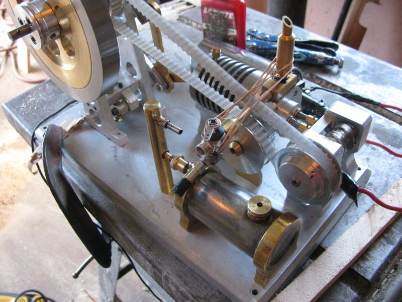

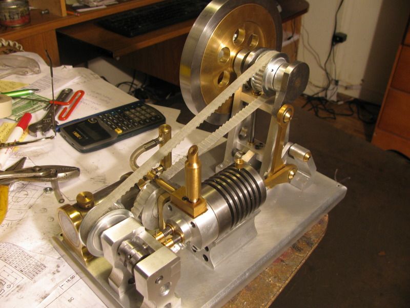

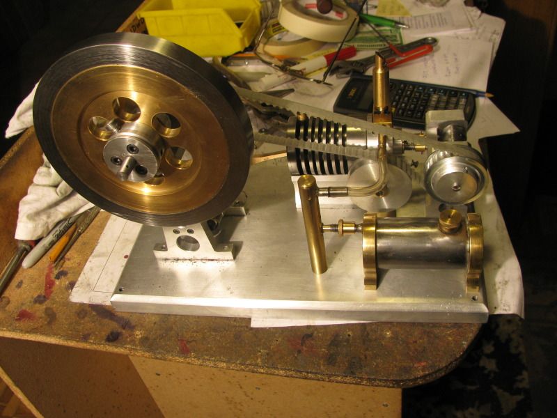

Hello all,
Here is a quick "catch up" of the little French flame licker.  AFCF1 designed by Christoph Fournier.
Hope you enjoy the flyby build log - I'm almost finished with the little engine.
These 7 things remain to be done:
1.  bore and ream the cylinder
2.  make the piston
3.  make piston pin
4.  trim the bearing pin
5.  make the pin for the connecting rod
6.  make the tiny valve spring
7.  get it to run   :hammerbash:
And here is a photo summary of how the engine stands now:
With permission of the original designer I have uploaded a copy of the translated drawings (unless something went wrong with the upload process - if it did, email me for a copy).
JW

A very nice build Jeremy, I've had the drawings for a couple of years . I see you have made some nice styling changes
The plastic base maybe a problem as all the flame lickers Iv built run very hot and the bases also tend to become rather hot after a decent run.
Many thanks for the drawings as these may be updated to the ones I have as theres a change to the cam
best wishes
Re: AFCF1 - a little French flame licker
« Reply #4 on: August 15, 2013, 12:28:20 PM »
Nice work Jeremy, the design reminds me a lot of Phillip Duclos design though more stylish.  I am a bit concerned that both the cylinder and piston are brass though. Have you considered graphite for the piston?  Looking forward to seeing this one run!!

Thank you for the advice - this is my first flame licker.  I'm going to be fixing the lexan to a stained wood base.  Having said that, do you think I should scrap the idea or do you think it's worth trying considering it will be fixed to a wood base?

Just not sure to be honest.I really like the look of the clear base and as its already made theres nothing to lose . I think over time it may become a little worn looking.
My little Blazer after about a ten minute run the base is too hot to hold in your hand for any length of time.
As already mentioned by Bill a graphite piston maybe a good idea.
Its my next  fit in build so watching avidly.
cheers
Offline Ian S C
  • Posts: 1080
« Reply #8 on: August 16, 2013, 03:37:12 AM »
If you can't go graphite for the piston, it might be worth trying a light weight cast iron one.  I don't like your chances with the Lexon base, I think that even wood would have difficuly withstanding the heat.  I imagine that the origional motor had a metal base.   A heat proof tile, or similar may well do, or there may be some types of glass. Your motor looks great.      Ian S C

Albeit might be a bit pricey, I think that Ian may have the right idea about some type of glass as a base. I personally rather fancy the look myself, it is different and the main parts of the engine are accentuated more.

Ian,  I've had my doubts about the Lexan from day one.  I just happen to have that beautiful unscratched piece and thought it would look unique.  I hadn't considered glass.  I do want the look of the Lexan.  I'd have to learn how to drill the glass for the mounting holes.  The original did call for a brass base and piston as well.
Other than weight reduction, any other benefits to graphite?

Something as simple as a piece of gasket material between the metal parts and the clear base may be enough to isolate the heat and if the same thickness is used throughout , shouldn't mess up any of the vertical alighment of the engine.  JUst a thought since you already have the clear base made As for the graphite piston, the main benefit is that it will be self lubricating. With a metal piston in a metal cylinder, you will have to apply some graphite powder fromt time to time to lubricate these parts.
