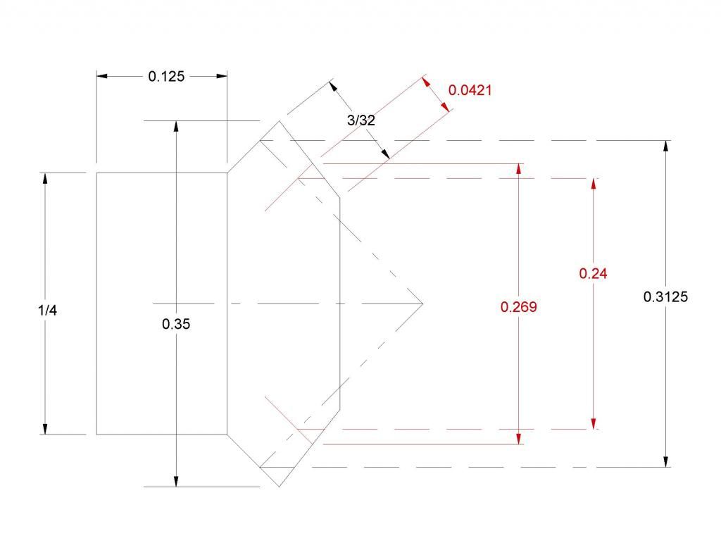

I've been rooting around the internet trying to find a collet stop to fit 3C collets.     This will be used on my newly rebuilt South-bend 9A.
Well I found an example made by a man by the name of Barry  ( who goes by the handle Saxalby on the Model Engineer forum)....and was very intrigued!
http://www.model-engineer.co.uk/forums/postings.asp?th=65935
....I made a sketch of something workable based on the photograph...and I'll get to it shortly....I have a couple of chucks to fit first.  Anybody else make one of these?

« Reply #1 on: July 12, 2013, 04:01:19 AM »
Here's the sketch of Barry's design that I put together in my note book.
After I get my chucks fitted though....

« Reply #3 on: July 12, 2013, 02:28:01 PM »
YUP That's it Kerrin.....I found another one too that I found ingenious...but a bit more complicated.  but it's a nice design!....I found this on Practicalmachinist...
