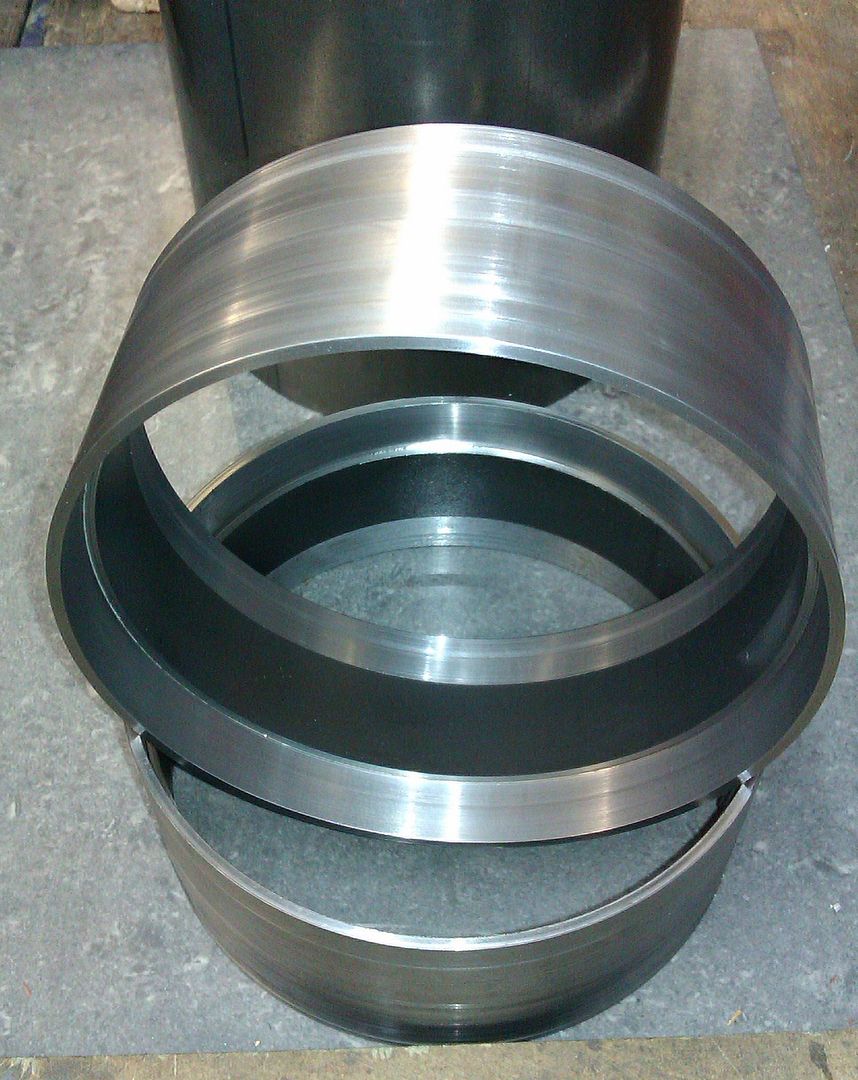

Some of you may recal that back in post #4 I said that I was considering not using the cast sub-base. I did fancy making the "cross cut rig" but after some consideration decided against that as at 1/3rd scale the whole thing would be about 54" long. Therefore I took the option of the "hand portable" cart and a bit of time spent on Google Images resulted in an old e-bay advert for an original Galloway hand cart and some useful dimensions in the description.
Armed with the sizes and photos I was able to arrive at a suitable design and decided to tackle the wheels first, this is what I was aiming to reproduce.
Luckily the wheels scaled out at 5.5" and I was able to buy some 139.7mm dia x 5mm wall ERW tube. I cut off two pieces long enough to get 2 rims out of each.
The rings were held in the 4 jaw trying not to distort things too much, that was why I opted to do two from each ring as at the early stages there would be twice the amount of metal so more rigid. The outside was just skimmed and a recess cut on the inside to take the rim down to 2mm thickness.
Once one was done it was just a case of doing it another 3 times before sawing down the middle to give the required 4 embrio rims
I also bought four 150mm x 5mm thick lazer cut steel discs from the same e-bay seller as the tube
And proceeded to trepan out the middle
Rather than cut all the way through and risk the central disk doing something you don't want I like to cut from both sides until almost meeting. Then support the disk and give the middle a whack and it should open up like a tin can
I then turned down the outsides so they would fit into the rims and rest in the bottom of the recess
Followed by a bit of silver solder
It was then back to the lathe to thin the other side down to 2mm, reduce the depth of the central web and then using a form tool to round over the web edge
That was a bit of a long one, next the hubs.

What did you use to braze those, just a torch, or a furnace?
Hugh.
  • Posts: 9495
Re: 1/3rd Scale 5hp Galloway Build
« Reply #114 on: February 04, 2014, 09:19:05 PM »
25mm nozzle & cheap torch on a 4.5kg propane bottle

Nice way of doing it, doesn't look easy but they're going to look spot on.
