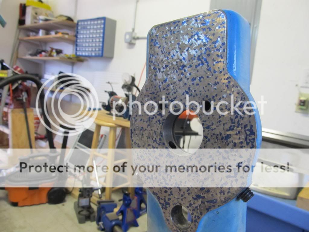

This is the bed, fresh off the grinder, and shimmed and leveled within Connelly's specs: The deviation from the horizon is 0.001" over the length of the bed (the saddle is just sitting there, not scraped in yet).

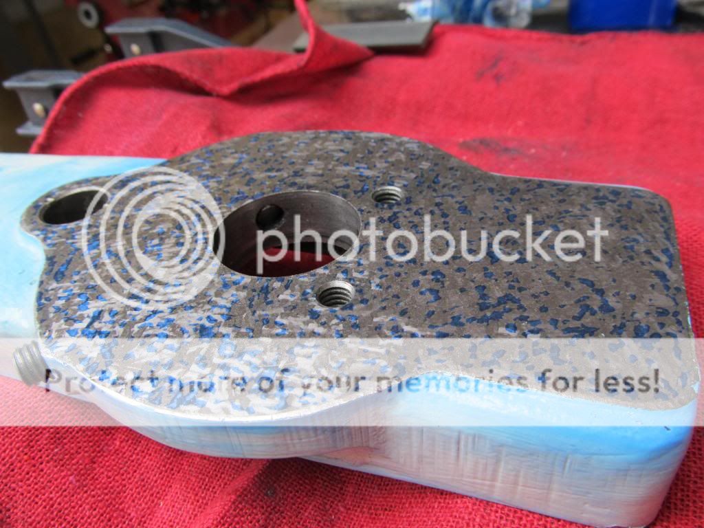

This is the cross-slide, after several cycles of spotting and scraping.  The upper surface
and the lower surface (sliding/bearing ways):

It seems to me that the cross-slide's bearing surface needs a round or two to carry better...
upper and lower surfaces of the cross-slide are within Connelly's specs with respect to parallelism. A tenths indicator registers under one tenth over the length of the ways... but my indicator is one I restored my self and needs repeated measurements to trust, and I am measuring on a chinese tombstone (to borrow from nick mueller)...
I still have to scrape the guiding way of the dovetail and the flat gib...

The bearing on the flat way is coming along nice.  A few more cycles.

You'll need a lot of patience (if that's your first). Spotting looks promising, but the way needs something like 5 more passes.
