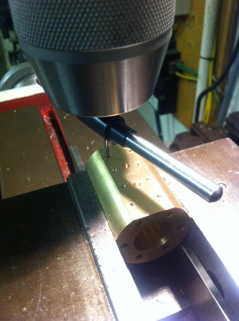

Next job was to drill and tap the holes for the valve chest. Thought I'd do this by coordinates the old fashioned way counting the turns as no DRO!
Seemed to work pretty well, centre drilled first then went back to drill to depth then start the tap off in each hole. Didn't bother with taper tap in small hole like this as it'd prob just pull out. Could have done to grind the point off to get a few more threads but it's ok.
Looks like I'd drilled the ports in between doing this.
Finished tapping off by hand, Jo would say these 2mm taps are massive but small for me and easy to snap!
Back into the mill on its end to drill the ports from end of bores. There was 1mm of meat either side so not too bad. This went well, pretty easy with this straight port design over traditional angled ports. Good simple cylinder design.
Finally mills the 2mm deep pocket to allow steam / air through.
Completed cylinder except for mounting holes.

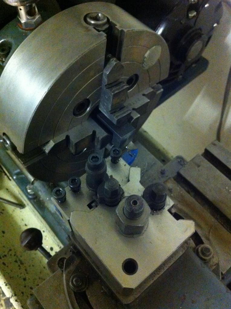

Hi all, been burning the midnight oil in attempt to make some progress on this engine it seemed like a box with a few bits a couple of weeks ago and it seemed the finish line was miles away.  :headscratch:
Anyway, here are a few pics of progress  ;D
Forgot how convenient using the 4 Jaw was for making small components flat! This is bringing the valve chest Down to size.

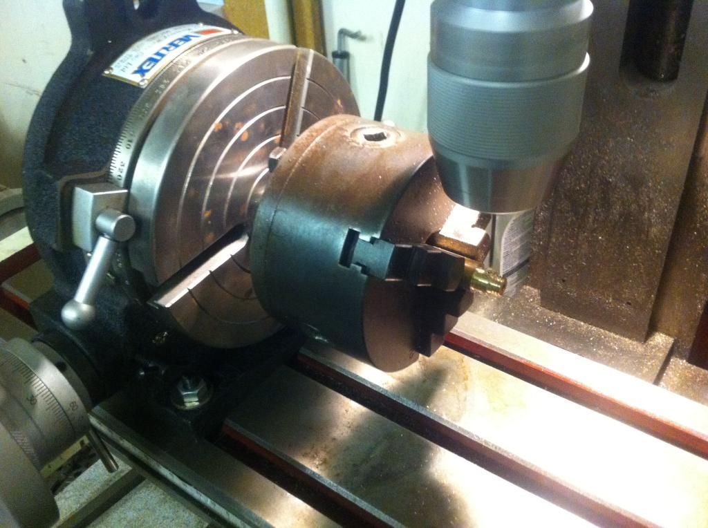

I didn't have any hex the right size for glands so thought I'd try something else new and try the rotary table on its side to drill tommy holes. Was planning on doing 6 but duh ... The jaw of the chuck was in the way on 3 of them so 3 it was! Collet chuck would be useful for this sort of thing but I'd need a 2mt one, beginning to think that would be quite useful actually.

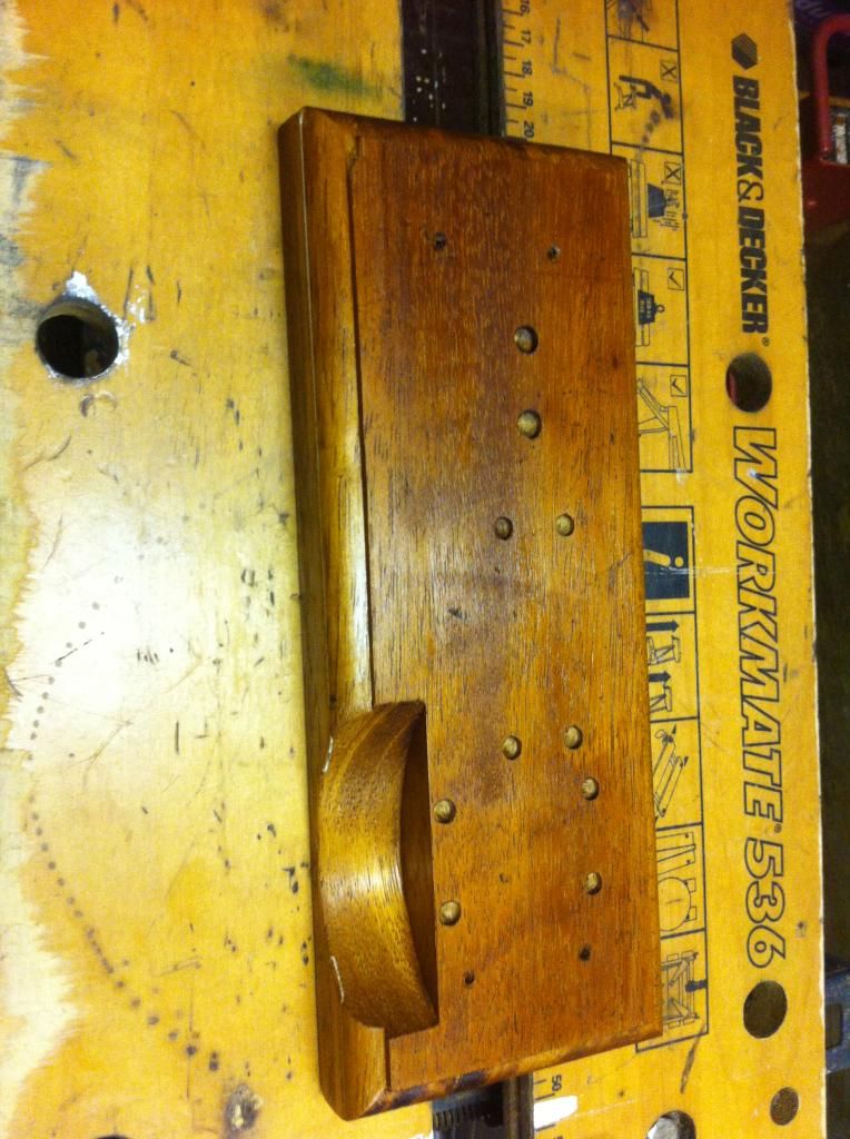

Was getting towards the home straight at this point thought id do the base then at least I could plonk all the bits on it for Harrogate.
Nothing to fear about the brown stuff if you just treat it like a bit of metal!  :Lol:
Genius ...
Apart from my first attempt had the screws through a softwood button in the middle and the cutting force proceeded to rip the screws through the wood and take a chunk out of the end of the base!
Flycutting cut out for flywheel lol always thought of this but never thought it'd work ... It did. White stuff is glue where the wood has had a joint down it at some point in its life.
This was risky - measured and calculated all the points for holes, marked for sanity check but done by coordinates using dials ... So need a dro!
This was a struggle working out so late at night after a day at work.
Another good reason for drilling base on wood - holes spotted through for clearance for screw heads on underside. Finished base with a bit of teak oil. Oh forgot to say I acquired a new toy for brown stuff from dad ... a router. This was much easier and faster than milling all the way around the edge and getting steps to line up!

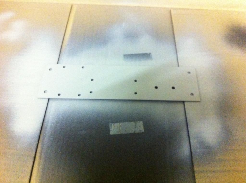

Coat of primer on base - this paint vie been using is pants, seems to take weeks to harden, some sort of enamel, maybe need to stove it !

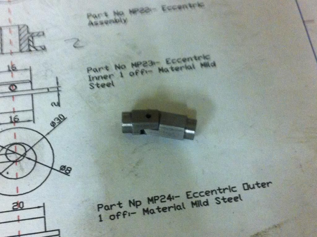

Eccentric - I decided to use a slightly different design here with a plate and a screw, think it was Elmers engines I'd seen it on. Drilling the offset hole in 4 jaw, then I could simply turn a shoulder, part off and part off a 2mm thick piece for the plate.

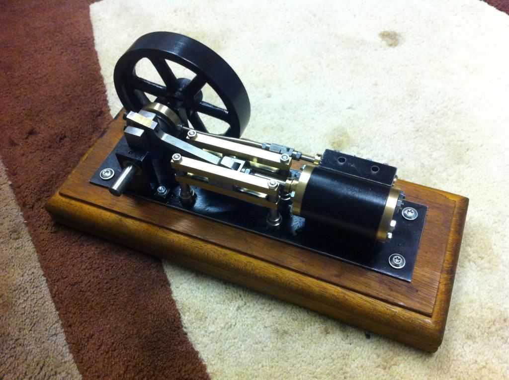

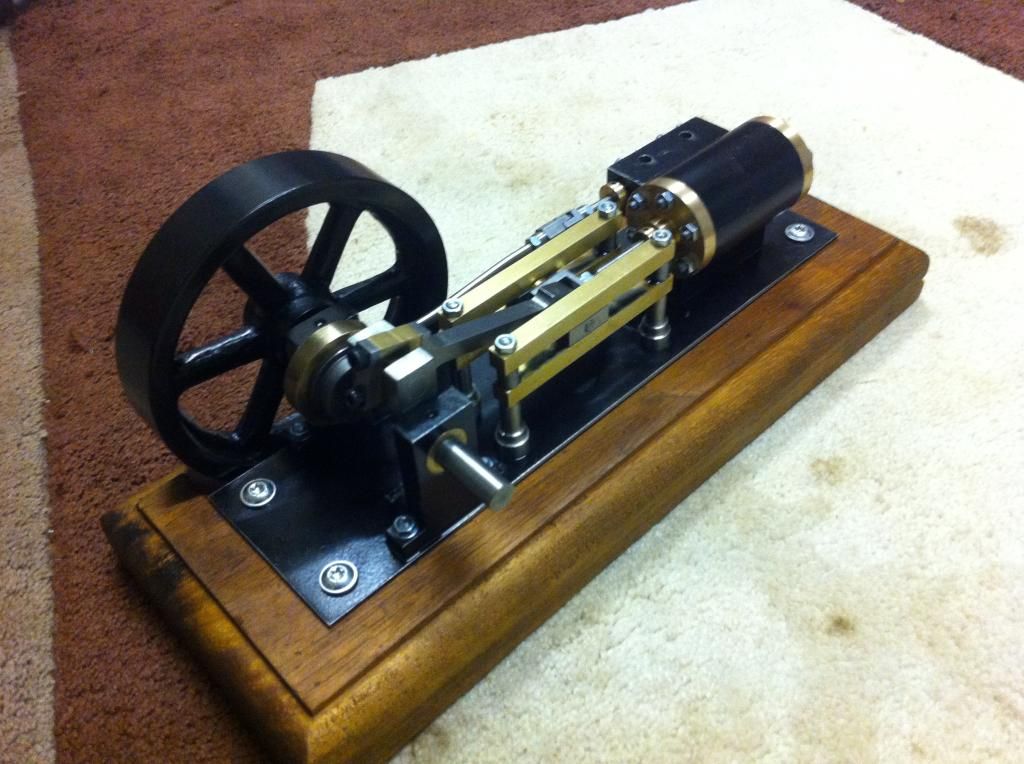

Phew - worked until midnight on Thursday and Friday night - absolutely knackered but finished just in time for the show - that'll teach me to enter an exhibit when it's just a box with a fee bits in it!
I changed the configuration a little, when I made the crankshaft it was to stews prelim drawings which had an error and it ended up too long with a gap between where the bearing and flywheel go. So I spaced the bearings out and decided to put the eccentric between the crank and bearing on the flywheel side to fill the gsp. This meant turning the cylinder around. I also turned the valve chest the other way up as I think before I bored it I realised it was a marginally better fit or lined up better with the ports that way before I bored it. This makes the inlet a problem, I was planning to have a pipe going straight down hen through the side of the base but ran out of time! This made getting a pipe on it v difficult today as the inlet was just a random this'll do sort of size and is a bit long.
It is all a bit stiff but I can confirm as of a few hours ago that it's a runner !  :whoohoo:Took about 15 psi as it's tighter than I would have liked - combination of binding on piston / rod and valve rod. I probably didn't get the machining sequence quite right so as to get no runout. Because I used stock sizes for piston rod and valve I relied on the concentricity of the chuck and collet chuck which with the fits I had wasn't good enough.  It'll loosen off if get chance to run it but sorry no vid for a while as I don't have a compressor  :( it was thrown together in a bit of a hurry in the end, gaskets are poor and really the baseplate is too think - 3mm aluminium which I thought would be ok when screwed down and all bits bolted to it but you can see it flex.
Oh, also, stud police should look away now, some are too short, some are too long but it's just cheap and cheerful fasteners! I found some nice (dare I say it, cap screws) for the con rod which were just the right length.
Enjoyed the project, lots of firsts for me and probably the most complex project I've done so far despite being a beginner's engine. Lots of learning points too - I was a bit down hearted last night when assembling as nothing seemed to be going right but after a bit of fine adjustment this morning I got it to a reasonable level of friction. Hopefully it'll bed in eventually. The flywheel has a bit of  a wobble due to my crankshaft fiasco but not going to dwell or start remaking parts, onwards and upwards and learn lessons for next time.
Thanks to Stew for designing another nice engine and sharing the plans - will have to show Lawrence when am back, I expect he's onto his next project by now!
Cheers  :cheers:
Nick
