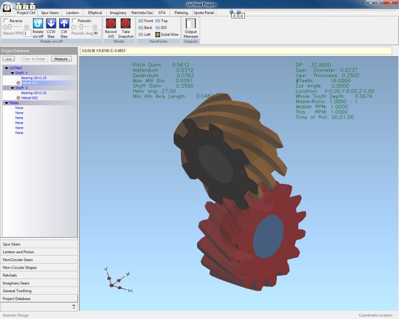

Hi,
I'm the bloke who bought everything that was left at Bonds when it shut!
Following your post I've dug through the stock room, which is full of gears of all cuts, pitches and materials.
Unfortunately I can't find any of these anywhere. :shrug:
Bonds part number c185 would indeed have been the item you are looking for. The original part number was 5/84.  I have found reference to the gear set in a 1964 Bonds catalogue but it doesn't appear in anything past 1980.
I also have a large number of  Bonds production drawings.  They produced their own gears until about 1975 when they moved from London to Midhurst and outsourced production. Since I don't have the drawings, I cannot even get a set of these cut (one off would be quite expensive but can be done).
What I can confirm is:
2:1 ratio.
Steel
Both gears have .562 pitch diameter
32DP
1/4 " bore
16 tooth cut 27º
8 tooth cut 63º
I suspect you need to contact Hemmingway who may have stock or may at least have the production drawings.
I Have loads of other 32dp spiral cuts but as the PCDs are all different you would have to make huge design modifications to get them to fit.
Best of luck sourcing a suitable alternative.
Al

  Thanks for checking Al. I do have an e-mail sent to Hemmingway but as its a weekend I haven't heard back from them.  Received your e-mail and replied before I read the new posts here.  I was able to figure out the 63 and 27 degrees with help from Marv Klotz's helixcf.exe program. Thanks Marv.

Offline John S
  • Posts: 141
Re: 2:1 Helical gears for Mastiff
« Reply #14 on: June 02, 2013, 11:47:29 PM »
If you have a 1/32" end mill, a copy of Gearotic and a CNC mill it's a doddle.  :stickpoke:
Took al of 5 minutes to do this using Al's information
John Stevenson, Nottingham , England
