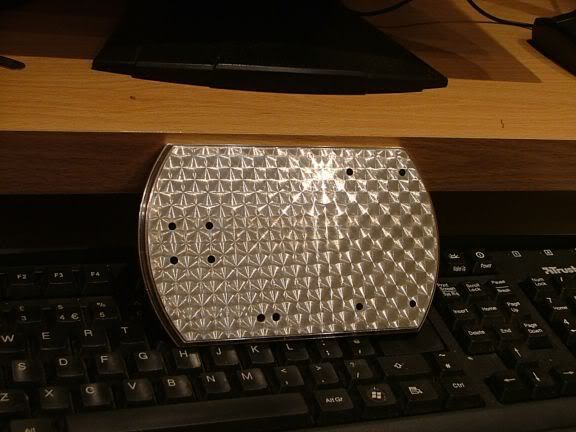

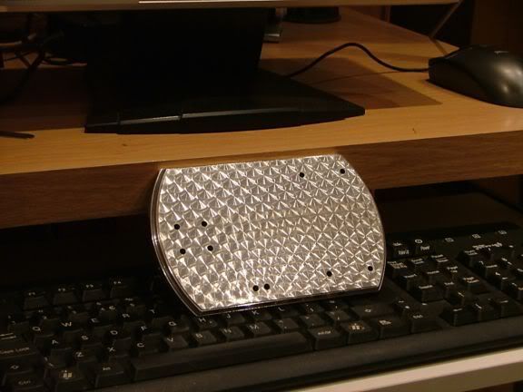

For many years I have been fond of the old horizontal steam engines used in lumber mills for pulling overhead line shafts that drove various millwork machines.  During my high school days our athletic field was located near a lumber company and the old mill engine could always be seen and heard especially during PE when we were outside.
I decided to build a model as my next project and selected the ME-1 plans.  It is an all bar stock engine and I plan to post the entire build here.
I started with the base plate and now have it completed.  It is made from 3/8" 6061 aluminum 3-1/2" x 7".  The plans indicated a need to flycut the surface where the various components would be mounted.  My X-2 Sieg milling machine did not have enough bed travel to allow using a flycutter that would cut the whole surface in one pass so I had to make 2 passes.  This resulted in tooling marks that I did not like so I decided to use engine turning to improve the appearance.
I used a 5/16" cap screw, faced the head, wrapped t-shirt material over it and taped it to the threaded part of the bolt.  I chucked it in the drill chuck and applied some valve grinding compound to the cloth and got a satisfactory finish.
The pictures below show most of the operation of the base plate from start to finish.

The only problem Dale, there is only so much damage engine turning can cover up.
Normal milling marks are not one of them.
I normally full width superfine flycut to get a surface good enough for ET.
When you get good clean engine turning, you should get an optical effect that gives a different pattern as the viewing angle changes, as seen between these two pictures. Plus of course, playing about with the spacing works wonders sometimes.
I am in no way criticising your work, everyone has their own rules to work to, I am just showing that with just a few more minutes work, it can go from good to exceptional, and that can only come from experience and practice, which I am sure, as you progress further, your work will become outstanding. :praise2: :NotWorthy: :praise2:
BTW, this plate took well over 4 hours solid to get the pattern and spacings correct. That is why I don't do a real lot of it.
This pattern is one right down the centre, then alternate sides of centre, sideways 50% backwards 50%, one of the easier ones to do.

« Reply #2 on: April 23, 2013, 05:57:27 PM »
Thanks John,
I agree!!  My engine turning did not cover the tool marks but did help to hide them.
Yours looks very good.  Thanks for your comments.

Dale,
Have a look at my signature line.
At least you had a damned good go, and got acceptable results, many wouldn't have even tried.
Keep up the good work, you're doing just fine.

« Reply #4 on: April 24, 2013, 01:24:37 AM »
Would it have helped to sand the machining marks out and then do the engine turning?
Not sure how flat it could be made on such a large surface, but would it have been flat enough?

« Reply #5 on: April 24, 2013, 07:35:47 AM »
I don't want to bog Dale's post down, so to answer your question quickly Zee.
As with everything you do in the shop, whether engine turning or wheel buffing, the smoother you can get the surface, the better the end result will be, and yes, flatting on a bit of plate glass ( or anything flat) with a sheet of wet & dry would certainly get rid of the machining marks. But you must be careful not to introduce ripples or curved edges.
