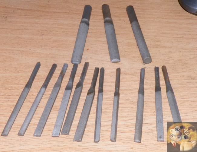

I also bought a load of new files from the link shown above, but they are mainly for just sticking up through the table, not held on their top end.

BTW, both Oliver and Victor aka victornet.com have files. Chainsaw files are parallel and I picked up two sizes at the big box store today. They should work fine upside down.

Chainsaw files are great.
The ones I can get come in three sizes, and they are dirt cheap compared to normal good quality files.
You can cut them into short lengths to be used for table protruding ones, maybe just an inch or so. But I prefer to leave them long and use the top tensioned support.

I did purchase an assortment of files from Victor Machinery; and at the GEARS show last year I was able to purchase some smaller files from Gary Martin (Martin Model & Pattern). I'm getting close to having more money invested in files than I paid for the machine.
