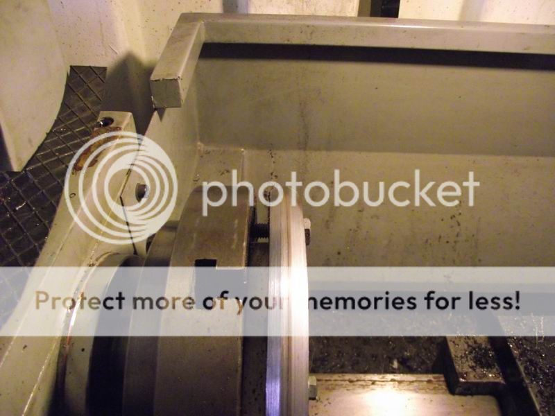

« Reply #32 on: September 09, 2012, 04:18:40 AM »
Steve and Pete,
Thanks for looking in and your support.  :NotWorthy: :NotWorthy:
I started on rounding the tube plates yesterday. It's going to be a slow process  :( The welds are as hard as the hobs of hell small cuts and 2 passes are the order of the day, otherwise the lathe is ready to jump off its' mounts.

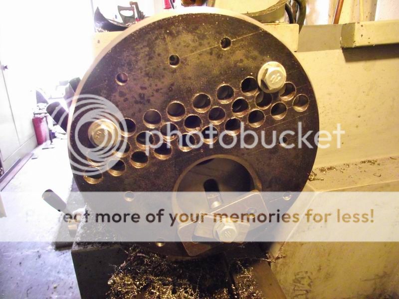

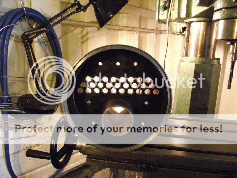

« Reply #33 on: September 14, 2012, 10:21:28 AM »
Hi Guys,
Are any of you having problems with photobucket?...........try as I might I just seem to be in an endless loop of login.   :killcomputer: In desperation I've signed up with Flickr and that's why these are a bit weird.  :facepalm:
At least I feel like I achieved something in the shop
Beveling the tube plates for welding.
A mock up the beast
Best Regards

A mock up the beast
'beast' indeed. That is going to be some boiler.
