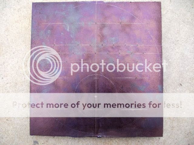

Hi All,
After a small delay for some real work. I finally managed to get the tube plates welded together and marked off for machining.
Best Regards

« Reply #16 on: August 10, 2012, 10:07:44 AM »
Morning Bob,
There's some work to be done there!.....pictures of the operation please!

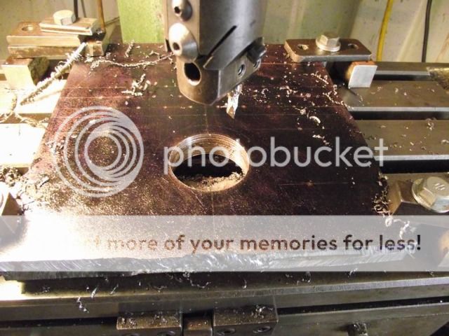

« Reply #19 on: August 17, 2012, 08:43:50 AM »
Hi Guys and Dave of course,
A bolt, a bolt, my kingdom for a bloody 5/16" bolt. Aha, found one, next cut up some packing blocks, of course not before a scrounge around to find the right size lump.
 Finally the tube plates are mounted and clamped on the mill. I seem to remember a honeymoon that went along similar lines.  :Love:
 Next came the boring job for the furnace which is about 3/4 done.
 Best Regards

« Reply #20 on: August 17, 2012, 11:42:31 AM »
Look at that, a dirty big bit of steel plate on the milling machine, complete with oxy cut edge. Looks like Bob is busy in the shop. Good to see  :DrinkPint:

« Reply #22 on: August 17, 2012, 03:46:59 PM »
Bob,
Nice progress, that is some nice cutting. I had to look several times to see that both plates are on the mill. :ThumbsUp:

Re: Scotch Marine Boiler
« Reply #23 on: August 17, 2012, 06:19:26 PM »
I'm pleased to see there was also some packing under the bottom plate otherwise there could have been some nasty scoring on the bed  and some educational words being said :embarassed:.

« Reply #24 on: August 17, 2012, 07:36:18 PM »
Bob, Jo makes a good point that big drill looks like the point will nick the table... must be an optical illusion... one of the dings in my table came from a similar setup. :embarassed:

« Reply #25 on: August 18, 2012, 01:30:33 AM »
Thanks for the support guys,
I'm pleased to see there was also some packing under the bottom plate otherwise there could have been some nasty scoring on the bed  and some educational words being said :embarassed: .
Yes, how true, I am sure had that happened I would have broadened your vocabulary by a considerable amount.
Dan
I must admit I was nervous about how close it would come to the table so.....................................I placed a length of 20 swg under the plates and when it moved that was deep enough. As it happens it was just deep enough to give full depth to the hole.

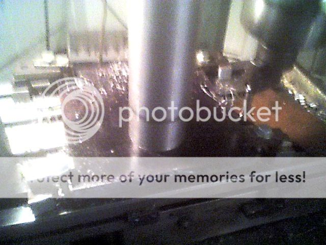

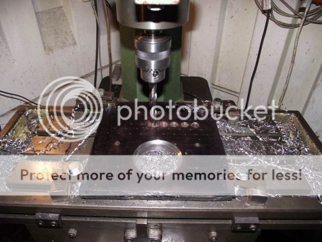

« Reply #27 on: August 24, 2012, 01:22:19 PM »
Hi Guys,
Honey do's for floating shelves in the study put the brakes on progress but I did manage to finish boring for the furnace tube.
Phorgot the Photoaparat and my mobilnick is nearly as old as I am so sorry about the crappy pics.
Best Regards

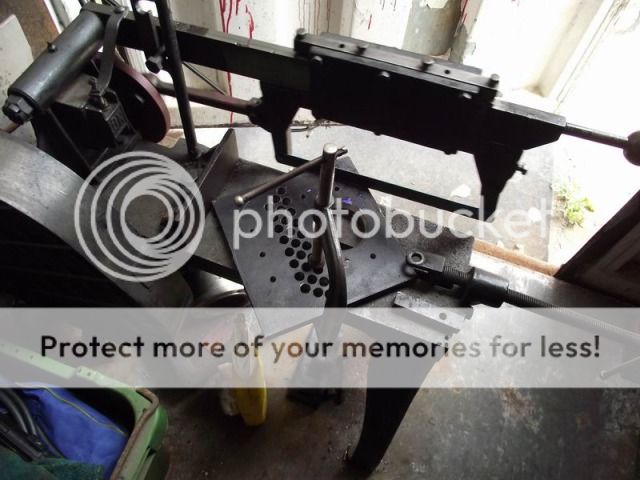

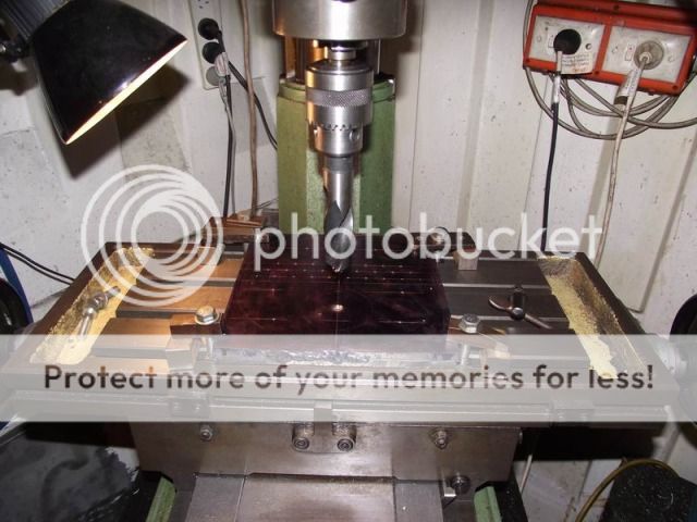

Remembered the Camera  :old:
Finally the tube plates are in the lathe ready for rounding.
Drilling and reaming the tube and stay holes
Chopping off the corners
Ready for the dial indicator
Have a good US labour day weekend.
