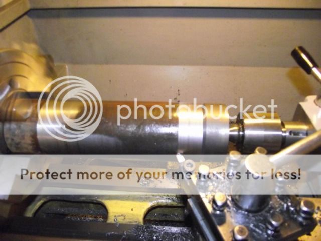

Hi Guys,
Geez am I glad I did not go for anything bigger. This really does not fit my lathe without removing things like the tailstock.
A couple of shots of machining the furnace tube. Why, because the piece I was given was 3000psi boiler tube and just a tad oversize for this boilers needs.
Outside
Then Inside.
Next comes the tube plates.  :insane:
Best Regards
« Last Edit: July 27, 2012, 08:13:20 AM by Maryak »

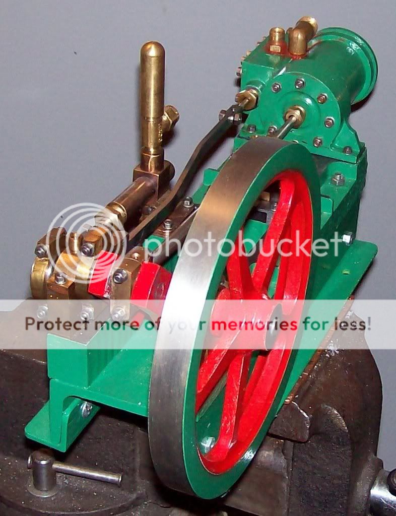

Second dumb question: any idea what you want to drive with this beast?
This
Plus I'm messing about with a compound twin generator.
Thanks for asking. There's no such thing as a dumb question. :)
