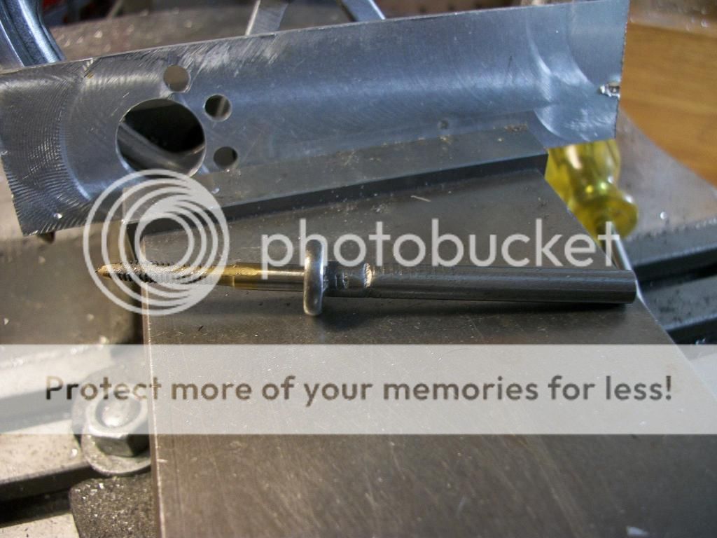

Tbh I find the photos a little difficult to view.
They seem a bit dark.
Could be handy though.

I've made a tool like that and it gives a lovely finish.
used properly the swarf comes off like cobwebs.
theres nothing new under the sun tho, L C Mason describes a tool like that in my 1963 edition of 'Using the small lathe'.
Roy.
Roy.
Ok Roy, I'll make one then!
Roy.
Yup. Words and music here:
Mason's version employs a round toolbit but the cutting principle's the same.
Joe

This type of finish tool can also be used with a shaper.
http://www.neme-s.org/shapers/columns/shaper_column_43.html

I wonder about the similarities with the Diamond Tool Cutter or Tangential tool

Goldstar31
Re: Surface finish
« Reply #12 on: March 03, 2013, 08:34:55 PM »
We are missing the point because there are TWO issues!
The first is the actual removal of large quantities of metal and the second is 'fine finishing'.
I think that there is plenty written about 'hacking' great chunks down to nearly size but what of this finish- the stuff that people look at. The rough turnings are the things in the waste but really lathes in a professional context, do this. Finishing and to size is something that is done- on a grinder.
What we- as amateurs are trying to do is doing it all on on a lathe.- and some of us are trying to do it with one tool. Rudely, and the Best of British Luck, mate!
If you want to do what the old turners did is to go back to what they recorded. None of this rubbish about this and that new gadget. The old boys 'honed' tools and used lathes that were pretty similar to what is rolling out of China today. What they could do was make a constructive effort to do the last bit of the work- on tools that were razor sharp. They didn't use Carbides or even high speed steel. They used carbon steel.
What did they achieve? Well, if it comes to the evaluation, can many of us flog a metal turning turning lathe to an Arab oil baron? The old boys could flog a lathe to a Tsar of Russia or some Clown Prince at a price of perhaps a street of houses. Go get a price for an old Holzapffel or Evans ornamental turning lathe- with all the goodies and have a hell of an awakening.
So how did these old men sharpen their tools? Merely with what some call a goniometer or goniostat which is a simple jig to sharpen a carbon tool on a bit of cast iron or glass or better still, on a piece of lead with progressively finer grades of abrasive which they crushed - and graded themselves.
OK, is this all written down and not some old bloke talking about some long lost black art.  Holzapffel wrote it all down and it is still on the net.
The diagrams are still there. Mine are on the book  shelf. One bloke recently sort of tarted up - and simplified a goniostat. It was a bloke called Conrad Hoffman and on advanced tool sharpening. If you have something like an old hockey puck and a bit of plate glass- you get on with it.
And yes, Mr Hoffman got it right- not to buy a street of house but RIGHT enough.  Read it up- and be surprised

A lot or most of the manufactured tooling is designed for max speed max feed rates and for machines far more rigid than ours.
There is a lot to be gained by learning to make our own tooling either in HSS or Carbon steel as well as saving money you can tailor the bit to the job in hand
Have a look at the sites already mentioned and you will see variations of tooling that has been around for many years
I find or found that start of with the basics as shown in LC Masons book or Mr Sparey and if it don't cut the way you want or expect then play around with the angles of dangle its not a black art but at the same time some thing you need to practice at its the same hitting sizes you see people measuring to within tenths this must be worrying to new comers when really all that matters to us is that the parts fit together it doesn't simply matter if the bore is slightly bigger than drawn just make the piston fit  but Im digressing
The old KISS is a very good ethic you dont need loads of fangled equipment to make toys yes if you want to make money but not for toy making
