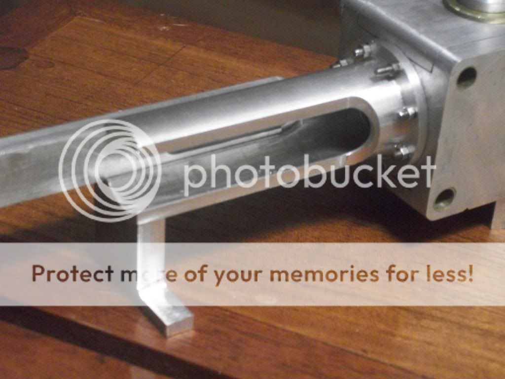

When I built my first Corliss engine last year, I was reluctant to call it a Corliss because I doubted that I could build a release mechanism at that scale.  That engine had a bore of .625" and a stroke of 1.25" and after several attempts, I am completely convinced of that.  The engine ran nice and smooth and the 4 valve linkage and wrist plate proved the design but without quick release gear its not technically a Corliss so here goes another one.
There are at least three builds underway to the design collaborated on by the moderators of this forum.  I think it is a good design and this new project of mine is just another way to go.  It incorporates ideas that I had while building the previous engine and has some design features that I just wanted to try.  It is bigger than my earlier design but not quite as big as the MEM design.  There are many similarities because the basic configuration of all horizontal Corliss engines share these features.
Here are the specifications:

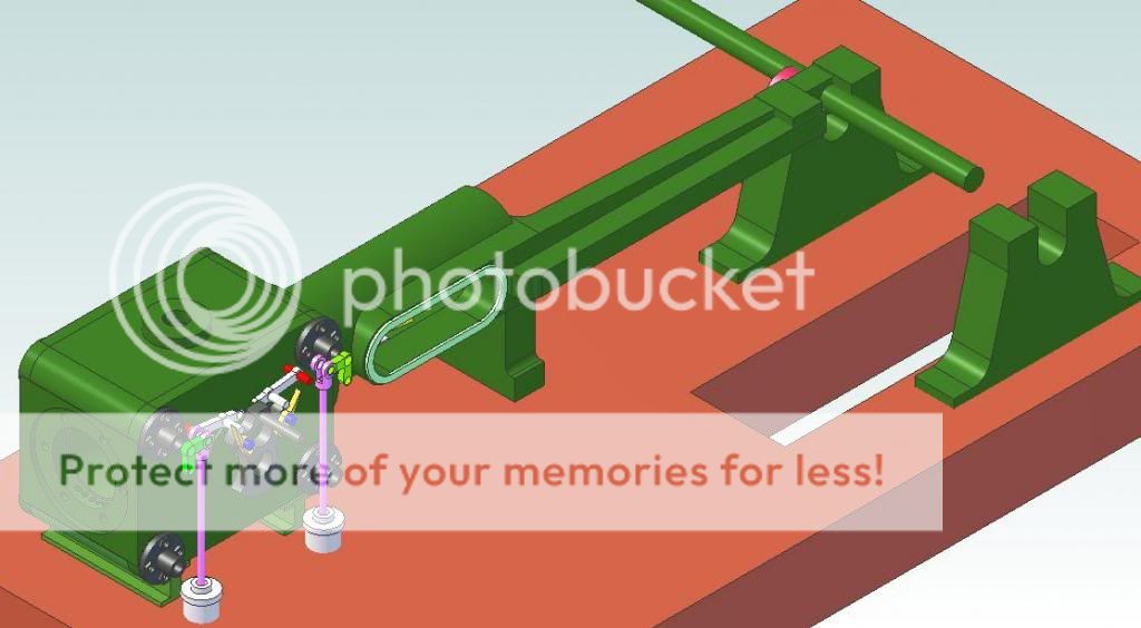

It looks like this so far:
There will be more.

This engine is smaller but not by much and in some respects is larger.  The stroke is the same (.75") but the bore is less. The cylinder block is the same length but on this engine, I have moved the valves  bores 1/8"  further apart.  I have kept the bore smaller to give a 2:1 ratio and because I hope that with lower displacement, it will run better on my small compressor.  I haven't found the piece of pipe that I will need for the flywheel rim but I am hopeful.  I might have to buy it at retail.  :'( I don't think that the size is as critical as it might be on a full size engine working under load.  I think that it is more of a visual relationship.  A big slow turning flywheel just looks better and with a long con rod (5") a smaller flywheel would just look wrong.   I think there will be more similarities than differences in these projects.

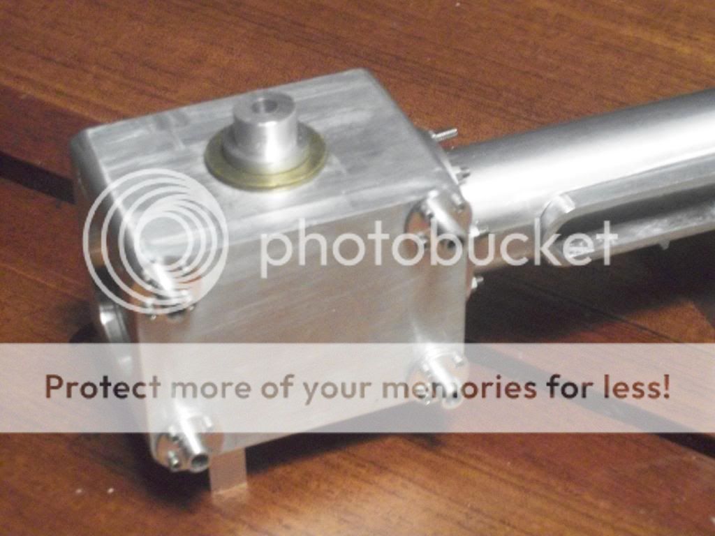

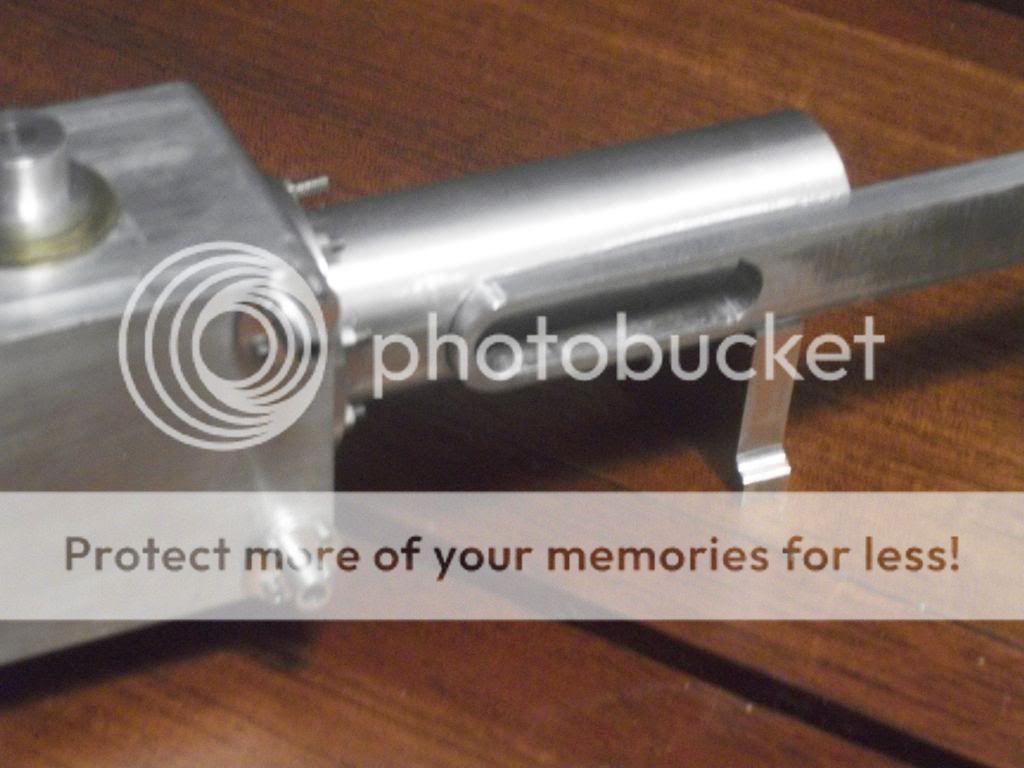

The cylinder block is a refined version of  my previous design where a top and bottom plate were bolted on to cover the steam and exhaust passages.  I never really liked the looks of all those bolts on top.  I also wanted to create the rounded over corners that are seen on many Corliss engines.  Here is a picture of the cylinder block with top and bottom plates removed.
The top and bottom plates are attached with long bolts up through the bottom so there will be no bolts visible  on the top.  Sealing at the ends of the plate was likely to be a problem and fitting the valve body in a split bore would demand more precision than I can muster so I have resorted to lining the valve bore using thin walled brass tubing.  I can not see any reason that I should need to access this area after final assembly so I plan to use epoxy adhesive/sealant to make the joint permanent and then use a high build primer before final painting.  The end result should have a seamless appearance.
You may have noticed the holes at the top of each of the valve liners.  These were drilled through to the cylinder at 90° for the steam passages.  They will be covered by the plate.
This is where it is headed but there may be detours.
More later.

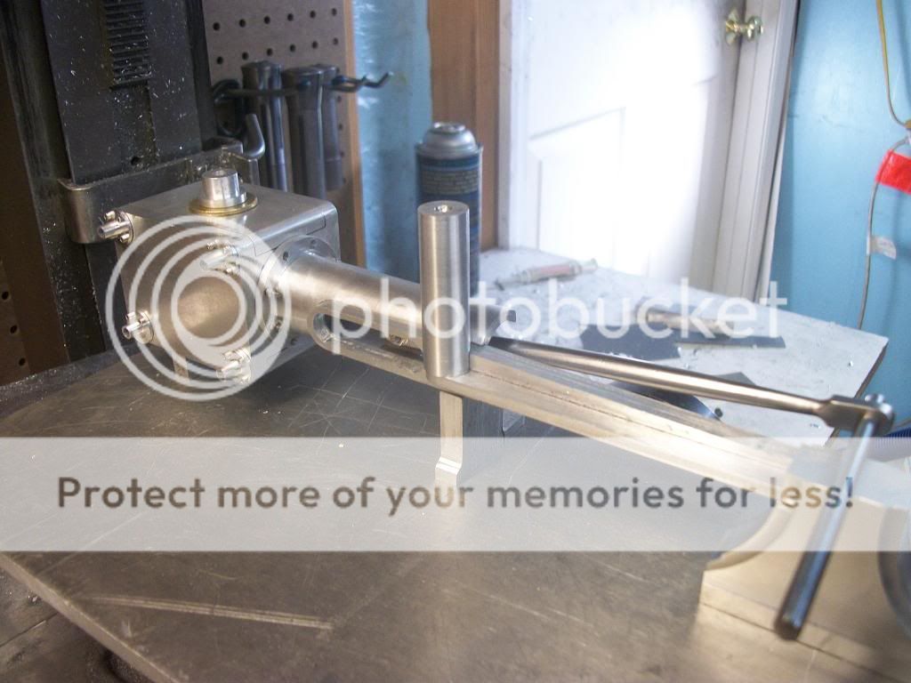

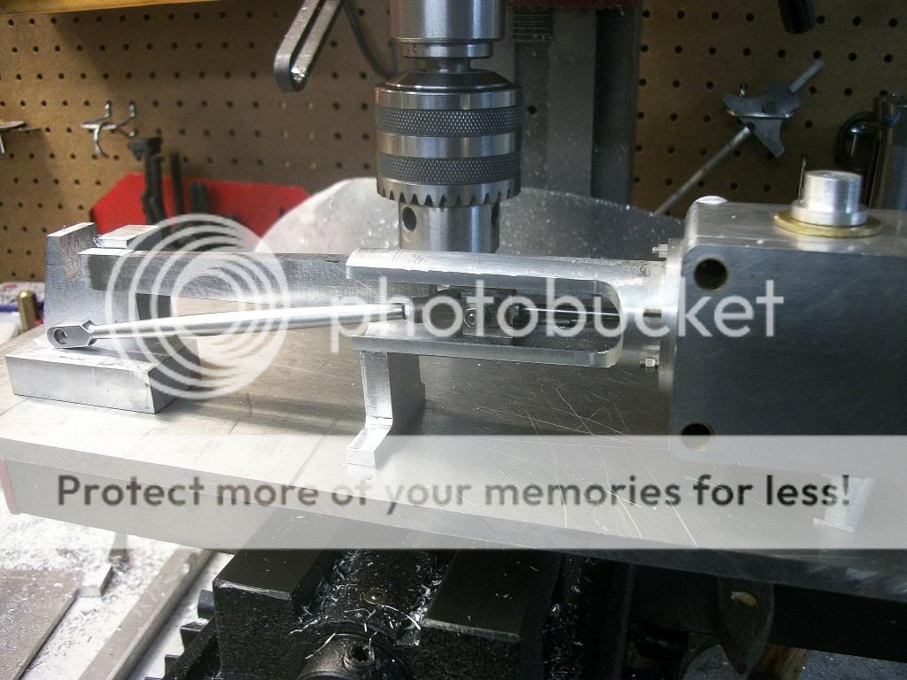

An update.

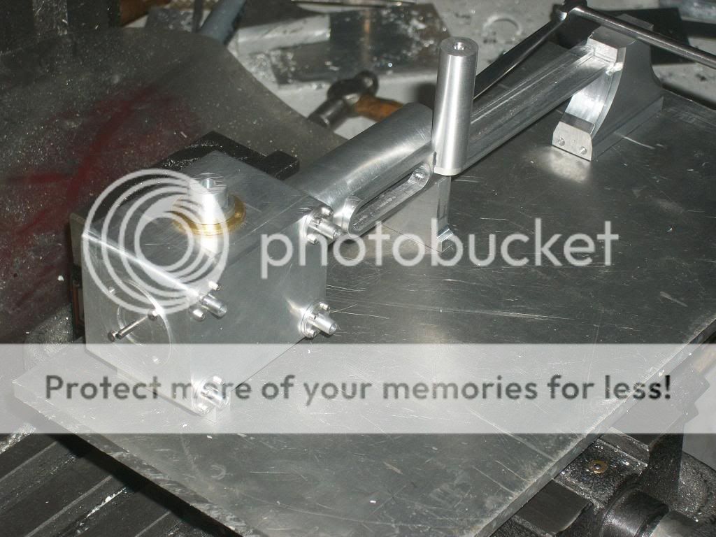

Not a lot accomplished this week due to other duties, but the engine now has a piston and a cross head shoe, both of cast iron. Diameter of both is .75 inches.  It also has a piston rod ( 1/8" drill rod) and a fish bellied (double tapered) connecting rod (3/8" nail ).  The connecting rod is a two piece assembly but it wasn't intended to be.
I had thought that I could work the forked end at the cross head from the base material if I was careful and I almost made it but disaster (or reality) struck and the fork collapsed.  The con rod now has a cast iron forked end threaded onto the stub end of the crapped part.  It doesn't look to bad, at least not to me.
Here are a few pics of the current situation.  The main bearing stand is roughed out but actual location and method of connecting remain to be worked out.  I needed the assembly of piston, piston rod and connecting rod to be work out the actual location and clearances.
More to follow.

Thanks for the explanation and photo, Jerry. Great stuff, all understood.

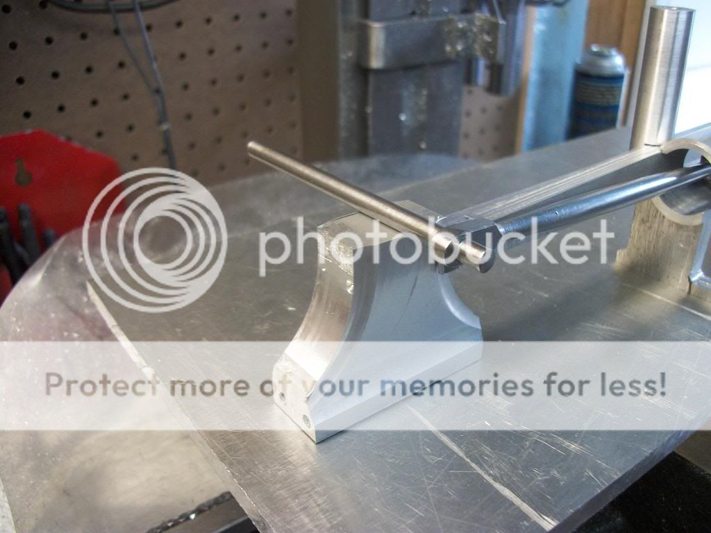

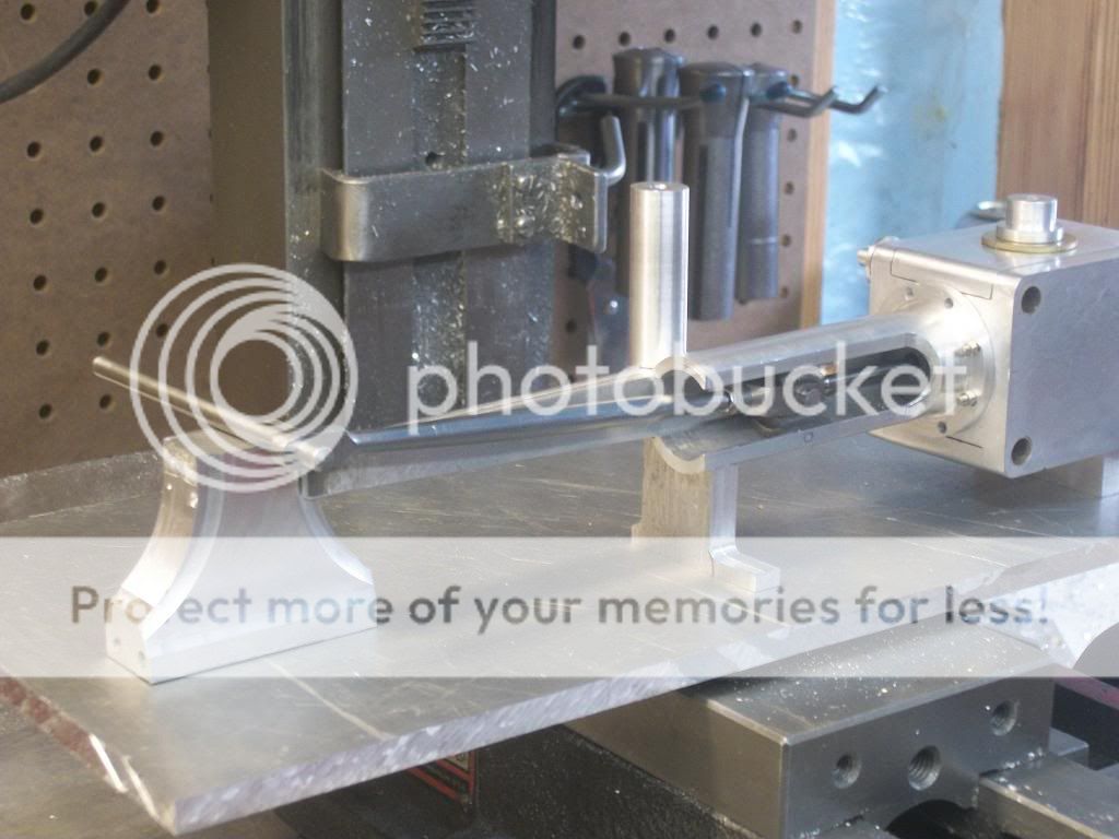

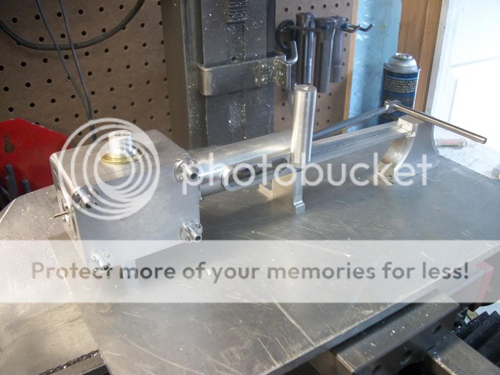

« Reply #12 on: March 05, 2013, 05:28:11 AM »
Here is a little more progress.
I have been battling the main bearing stand for a few days.  Alibre was no help.  It is too easy to draw things and make them fit. There is a problem with that.  If the finished part doesn't look like the drawing which one is right?  I'm going with the part.  Not spectacular but here is a picture of the curved faces being fashioned with the boring head.  Not hard at all.  My mill would have not survived this interrupted cut before converting to belt drive.  If you have an S2 mill with gears, get the kit and change to belt drive.  Its night and day.
The girder frame just didn't look right.  To thick so I applied a little more taper.  I also added a stiffener to the side which provides more strength and gives me a place to mount the governor tower.  The tower location is now set but the tower profile is not yet decided.
I think I have things located now.  Next efforts will be to clean it all up, prepare a proper base and begin to fiddle with some fiddley bits.

You won the battle of the bearing stand, Jerry. Nice curve on it, with a really graceful undercut chamfer.
