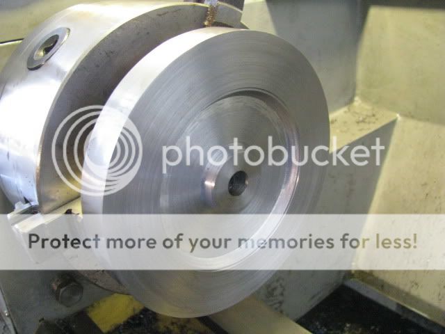

A V type tool is one of the options to turn the recess.  Another option I tried today is a 6mm HSS round section tool I have which also gave promising results.  For sure I suspect there will be a fair amount of tool changes whilst making the recess.
How are you planning on holding the workpiece to the faceplate to recess the other side ?
The plan is not to use the faceplate for the other side.  I will be holding the thin section of the hub with a 19mm collet and a live or dead centre on the other side.
Hi Vince,
May I suggest you give some thought to reversing the jaws in your chuck and using them on the inside of the recess of the 1st side to machine the 2nd side recess. Your collet method means you are a long way from any support as you approach the rim and fpm speeds get higher as you move away from the centre.

« Reply #17 on: February 21, 2013, 10:23:26 PM »
Bob you are right.
There will be no support from the back when working close to the rim.  I did not think of using the chuck in that manner because I discounted the use of the chucks that I have as they are relatively small.  Also I was more preoccupied with keeping both sides concentric hence using the collet.
I will have to rethink my strategy and investigate if it's possible to use one of my chucks.  I can't exactly remember what size of chucks that I have at the moment.  I think I have a 4" 3 jaw chuck and a 5" 4 jaw chuck for the lathe and a 5" 3 jaw chuck on the dividing head but no backplate for the lathe.
Thanks for the heads up.

« Reply #18 on: February 21, 2013, 10:45:13 PM »
Vince,
Just another thought on a rigid set up for the second face. If you have a slice of material that you can bolt to your faceplate as a sub plate (or hold in the 3or4 jaw) that is just slightly larger than the recess diameter in the first side of your flywheel you can turn a register on the OD of the subplate to fit the recess diameter and hold it using a bolt and large washer through the bore (threaded into the sub plate). Remove as much metal as possible outside of the washer then as you move toward the centre you turn the washer away too until the hub diameter is reached.
If you dont have a spare slice then bolting four pads to the faceplate will give you the same but you'll need a drawbar through the spindle then.  I use 6mm capheads or button heads for all bolting / clamping like this counterboring for clearance if required
It's a good way of getting a rigid set up - hope that makes sense

Well this morning, first thing I checked was if any of my chucks will be suitable for this application.  None of them will hold the flywheel in question.  So most probably I will have to use Ramon's subplate suggestion (if I find the material).  As it is, I still needed to do a subplate for my 6" rotary table to do the flywheel spokes.  So this same subplate would be used in both operations.
Just two questions.  Ideally the subplate should be round to fully support the flywheel, but if it is rectangular would that be OK?  Would an aluminium subplate do the job?
Thanks in advance.
  • Posts: 15294
Re: Vince's version of the MEM Corliss
« Reply #23 on: February 22, 2013, 11:13:14 AM »
The subplate can be any shape that you can mount on your faceplate, without anything catching ;). Aluminium, so long as it is thick enough for bolting to, would be ideal.
« Reply #28 on: February 23, 2013, 11:34:39 AM »
Not much to show but still a little progress.
The OD of the flywheel is finished 0.1mm oversize for clean up.  The excess material has also been faced off.  Left about 1mm to be faced off from the other side.
The face has been marked to be recessed.
« Reply #29 on: February 23, 2013, 02:29:02 PM »
Nice setup Vince, a T slot face plate. I had made one for my small Micro mark lathe. Works great for some setups.
