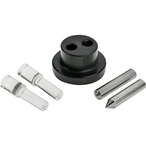

Anyone have any observations/suggestions/pictures etc before I start making one?  :)
I don't have any suitable brass (which I'd prefer to use) so the base will probably be alloy. I also plan to have just one hole in the centre of the base and store the punch in a hole in the box instead.
Offline John S
  • Posts: 141
Re: Optical centre punch
« Reply #1 on: February 17, 2013, 12:29:12 PM »
Good idea the one hole.
Knew someone who made the two hole model where the lens / punch sat in the spare hole then missed the punch with the hammer and smashed the lens into dust.
Hasten to add it wasn't me, I have a bought one hole model and usually when I make a cock up if far bigger than that  :P
Don't forget the groove in the bottom to glue an O ring into so it doesn't slide all over.

i made  one a couple years ago. I tried poly carbonate for the lens. Lucite works much better. my commercial  one has cork on the bottom. the one i made ai used a rubber pad.

This thread has me thinking about something that crossed my mind quite a while ago and that is, has anyone made one of these optical punches that incorporated a small LED in the base to better illuminate the area being scrutinized? I have never used one of these devices so do not know how much ambient light gets down into the bore but just thought that a bit more light might be beneficial. I've read the ups/downs of using different material for the clear locater piece as well. It would seem to me that a glass rod would be best suited for the job but handling glass would cll for extra safety precautions. These are just random ideas but am sure that others have had similar glimmers of questionable knowledge and perhaps they would be willing to share them with us less accomplished souls.  :slap:

The original ones were made by a firm in London called Dankroy and came in a jewel type padded box, well made and well presented.
they used to advertise in ME.
I bought one of these, reckon they were about £42 which was a fair bit of dosh at the time.
Few years ago I fancied getting a couple of spares and managed to track the guy down. he was a bit amazed i had found him as he's been retired a few years. Long , short was there were no spares but he did tell me he had problems producing the lens part to remain consistent and these were actually ground from perspex rod, then polished.
With the advent of CNC that curve would be easy to do. I even had a friendly physicist work out the required radius so it focused at 40mm long. Interestedly enough that distance alters depending on the material and reflection of light, glass was either half or twice [ can't remember ] the value of perspex.
John Stevenson, Nottingham , England
Arbalest
« Reply #6 on: February 17, 2013, 06:18:27 PM »
The ones we have at work have Acrylic (Perspex) rod. How much light hits the target depends on how much of the rod extends above the base I expect. There was an article in Model Engineers Workshop of how to make one.

I scored one for free*, it's a two-hole type, cork base, it has a small "o" printed at the bottom of the plastic rod, simply centre that on your X and the job's good. I take the plastic piece right out when I'm bashing the punch, purely to avoid the "oops, missed" scenario.
Ambient light should be enough so long as your workshop's well lit; mine doesn't work so well in some of the darker recesses of the shop.

Grizzly H5781 Optical Punch Set
Two punches 60 degree and 150 degree and two lenses cross hair and bulls eye.
US $ 36
My marks on and my home made shop made one both work well.

For those that want to make their own this is the site I used when I made mine. I turned out ok though I made the base from steel for the weight factor. Hope this helps
http://www.gadgetbuilder.com/OpticalPunch.html
