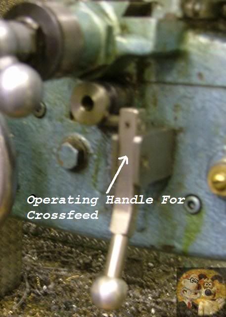

A very fuzzy picture here, but it shows enough of what I did. I turned up a pulley with a 1/4" full depth round bottomed groove in it (1/4" deep). This was the same diameter and central bore as the actuator knob, and they were swapped over. Then a little bracket and a bent handle were knocked up, pivoting towards the top of the handle, the bend was to allow the bottom part to not hit the apron so that the top half had enough movement to operate the linkage with a piece of 1/4" unhardened silver steel used in the knob groove to move the operating linkage in and out. It never failed to work and the crossfeed became a joy to use rather than a PITA. For a quickie guesstimation of sizes and lengths, I think I made the handle out of 1/2" stainless square bar.
