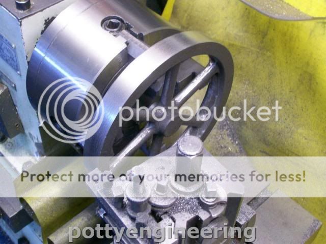

On to the lathe, and mounted on (or rather over the body of) the 4-jaw chuck in the head gap.  I left just enough space for the chuck key, and the lot fits nicely in the head gap:
I had to set the top slide parallel to the lathe ways and crank it in to maximum to get enough clearance to be able to turn the workpiece without the carriage hitting up against it.  This literally is pretty much my Myford's limits.  There's some room left in the head gap, but even so, the cross-slide was just barely hanging on by a few threads on it's feedscrew.
With slowest speed back-gear engaged, I started turning the workpiece.  It was only during this operation that THE PENNY FINALLY DROPPED:
I was looking forward to the smell, taste and black hands that come from the dust of turning cast iron.  And fully prepared to duck the stream of tiny chips it makes.  This material didn't do any of that; it came of in stringy swirls, didn't generate dust or give me any of those other (to me) feel-good cast iron experiences.  In fact, I'm now pretty much convinced this isn't cast iron, but rather steel, and the bad experiences with the slitting saw, the stringy burrs on the bandsaw and all the rest adds up.  That changes the ball-game a bit, and I have to re-think how I'm actually going to construct the flywheel.
I finished the shop session by rough-turning the outside of the workpiece to get rid of the crud:
So, now I have to sleep on what I'm going to do next.  With the original intent of the material being cast iron, I was going to bore out the rim section I did today by about 50% on the ID, then cut off another shorter section from the parent stock to turn down to a press fit inside the rim and drill it on the periphery to fit the flywheel spokes.  Right now, I'm not keen on the "extra" ring idea anymore; I might just bore out the rim to leave an internal "ring" in it, make a hub and spokes, make that fit inside the rim and solder the lot together.  Choices... Choices...
Yer gotta think outside the box matey, a stout boring bar, taking a HSS bit, mounted at the rear (operator's side) of the topslide will restore things to a more rigid condition. That's how I did this rim, tho, sadly, no pic of the actual set-up.

As Tel said when faced with a problem like this you have to think outside the box. If you flip the tool over and hold it in the near side of the tool post and run in reverse you'll have a far more secure set up, the metal doesn't give a dam which way the lath is running or which was round the tool is. like this
I take it you'll have to turn down the OD some to make the inner rim, well if you turn it down whilst it's still on the parent material, this way you've thinned the section down so you could then part it off from the inside with a cranked tool or use the same tool upside down  working from the outside.
Hope this helps I'm sure you will come up with a solution.

Bill, yes, it's definitely steel.  The biggest problem was that I was trying to machine it like cast iron, and I was just plain miffed at myself for not catching on sooner that it was steel; all the signs were there  :-[
Vince, you know it   :cheers: - fortunately I won't have as much milling to do on this one as you did  ;)
Jim, thanks my friend.  Just make sure those weeds aren't wet, else you might also end up with the 'flu  >:D .  You'll be happy to know that I'll be hacking off another piece from the parent stock to make the inner rim, just like originally intended.  I don't think everyone will have as many problems with the flywheel.  There is the option of buying a casting for most.  The biggest problem for me is that it's a rather big job for my lathe.  I'll have to start saving up  ;D
Tel & Stew - yes, the boring bar was my next option.  Unfortunately, it's one of those "make-a-tool-first" options  :ROFL:
Stew, good tip about running the lathe in reverse.  I can't do that though; the Myford uses screw-on chucks, so machining in reverse could prove interesting...
Thanks Carl - had to try and make the post a bit of fun, otherwise it would be terribly boring  ;D
Thanks Ron - but I'm as much a mortal as everyone else.  This build (not just the flywheel, but the entire engine) is a steep learning curve for myself, as it's a much bigger engine than I've built to date, so there's a lot of new techniques that I have to use.  It's a lot of fun though!
There's not much to show for today's shop session, though I made lots of chips.  Now that I know this is steel, and that I'm going to make the flywheel with a separate inner rim, I finished off the rim to a better standard, and started boring out a lot of excess.  This was slow-going; to get any kind of sensible surface finish, I had to go right down to lowest back-gear speed.  That also meant fine feeding.  On the ML7, the apron feed is a bit coarse, so I just locked it to the leadscrew and fed with the leadscrew handwheel.  That gives a finer and more controllable feed.  I did something I've never done, and that was pull up a stool next to the lathe, and sit down while working   :-[ .  Eventually got to this state:
Once that was done, I reversed the jaws in the 4-jaw chuck, and clocked up the rim in it again to start work on the other side.  It clears the lathe bed by 1mm on the front part of the bed, and by just 0.7mm on the back part...  That should be enough; it's a bit close, but I'm not going to be heavy handed during the rest of the operations; slow & steady will get the job done just fine:
After setting up, I faced off the front to true it up; no photos of that.  And then I had to call it a day; four hours gone and not much to show for it  ::) - this might be a bit slow  :lolb:

Arnold you can always sneak up on it from behind:
Or in the case of a Myford make yourself an extension that bolts on using that spare tee slot in front of the standard tool post. Nothing sexy just a piece of thick steel bar with a holes to enable you to clamp in that tee slot, (or clamp it down at a jaunty angle if you are going  :o really wide) ... If you have the original Myford tool post kicking around all you have to do it put a 7/16" BSP stud in the other end and you can transfer over the ball handled clamp as well.
