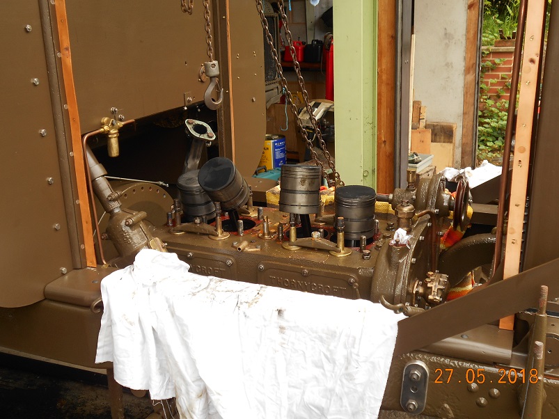

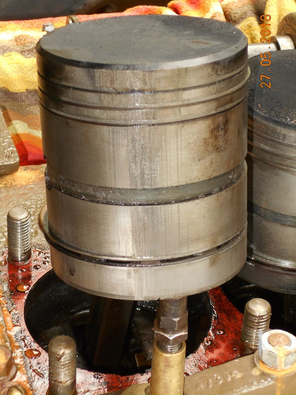

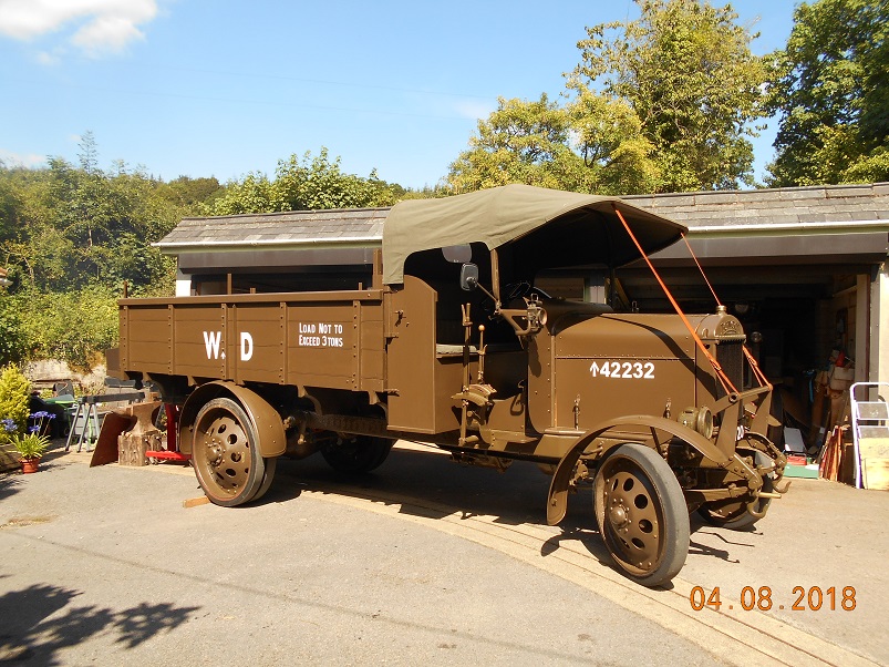

Well, I see that it is almost six years since I posted this. The lorry project has taken a bit longer than hoped for so my Mercedes engine project has only just started. In the mean time, we have almost finished the lorry and this is what it looks like now:
It was built up from bits collected from all over the place including the engine and differential from New Zealand. The engine had spent sixty years in a field full of water so it really was a major undertaking to bring it back. Just getting it apart was challenge enough! We made lots of new bits for it including new pistons. The bores were so bad that there was not enough metal to skim them out so we linered them instead. Unfortunately we lost 3/16" from the bore so the old pistons couldn't be made to fit and I had to make some new ones. On our first run out, the engine idled well but as soon as it was under load, it seized so we took it apart for a look.
We reached the conclusion that I had made them too tight in the bores with a constant clearance of 0.008" so I set them up in the Myford and skimmed them in steps so that they are still 0.008" at the skirt but 0.015" at the crown. This is something of a rattling fit but seems to be fine. We have had one test run which went well but on return to base we found the sup casting leaking and the petrol tank had split. The sump had lasted 100 years and chose that moment to give up! Anyway, I have now fixed the sump and the tank and on Christmas day we plan to put it back together.

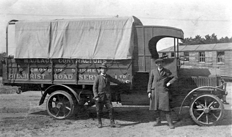

Here is the pic of the two wagons, plus their operators, my Dad and his Dad. The location is at the foot of Grenfell Hill. Just past the pub the road swings to the right and uphill. I don't remember the gradient of that hill but i recall cycling up it in the school dinner break was hard work. Perhaps the engines were more powerful or more geared down than I thought.
They converted them to charabancs for seaside trips by putting in bench seats. I presume the floors were swept as well.
My Dad always looked back to those happy times. He told me they were Morris Commercials. I have been unable to check this.

Thanks for the pic Jerry. I reckon they are Albions, almost certainly war surplus, like this one. I don't think Morris Commercial ever built solid tyred vehicles. Albions were notoriously slow but would climb the side of a mountain.
