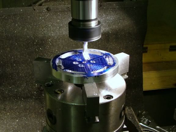

So the RT is now onto the table, centred up at 0,0, the chuck has been fitted, with your outside jaws in the chuck and the part to be machined in the jaws.
Unfortunately, in my case, I am not quite ready. What do I spy on the end of the table to the right.
You guessed it.
In my case, I fit a set of soft jaws and machine them up to fit the part. I have a definite fetish for accuracy, I just hope you don't catch it, and use your outside jaws, just like normal people.
So the job is held tight in the chuck jaws, and I have the angle set to zero on the RT.
The main table was set to zero both in the X & Y axis.
We start to set up to drill. I will be doing the inside set first, because this is the easiest to do to begin with. An 8mm drill is in the chuck.
The drill points around the circle will be 30, 90, 150, 210, 270 & 330 degrees. These are the centre points between the main spokes.
So I set the first one to 30 degrees.
The Y offset was set to 13mm.
It was at this point I started to lose it and forgot to take pictures.
I drilled each hole just over 9mm deep at the above angles and offset, this depth was because I don't want the drill tip to hit any part of the chuck jaws. This pic was after I had finished the full circle.
The RT angle was then set to zero. The placement of the holes on the outside circle is 0, 60, 120, 180, 240 & 300 degrees.
The Y offset was then moved to 38mm (remember the workings out on the drawing), the position of the outside holes.
Then the table was moved to a positive reading in the X axis of 6.5mm. This is to give us our spoke widths.
This pic shows the drill at the outside and offset position.
Again, no drilling pictures. I drilled the series of six holes at 60 degree spacing.
The only adjustment done on this manouvre was to move the X axis to -6.5mm, then the repeat drilling of the set of six holes at 60 degree spacing, the same setting angles as the previous set.
If you managed to follow my instructions, you should have ended up with a set of holes looking like the pic below, except for the blue marking, I put that on to show when the blue bit was removed, you would be left with the makings of your flywheel.
It was at this point I gave up.
I know most of you don't have the equipment I have, and will have to rely on using your X & Y handles to give the offsets. I showed the DRO's display because it was the easiest way of showing what was required at each operation.
Once you can get the basic understanding of what is required to make a flywheel cutout on the RT, you will soon be doing what I do, plan it out on a bit of paper and just cut away. Believe me, once you have got the first one under your belt, you will kick yourself for not doing it before. It really is a reasonably easy operation to do. But time consuming at times.
So what you see here was my next step. I have blued up the whole lot, and using an old ballpoint (doesn't scratch like a scriber) I drew on what needed to be removed. I also fitted a one sized smaller SLOT DRILL. The slot drill will cut all the gooves much easier that an end mill, and by going one size smaller, if I cut to the original dimensions used for the holes, it will leave a small amount of material to be removed to clean up all the edges. You could use the correct size of end mill for doing this first stage and miss out the second, but your hand cleanup time will take much longer.
I will be going thru the whole sequence twice, the cleanup one takes hardly any time at all.
The top slot is done first, but if you remember, the holes were drilled offset to allow for spoke width. So what we do is have no offset, and just set the Y distance at 38mm, the distance we used for the original holes.
Now there is no angle used for this part, it is all done by eyeball. What you do is start in the middle of the arc and cut using the RT wheel until the cutter reaches about half way across each end hole. I did these at a cut of 1mm deep each time until it had penetrated thru (8mm), in fact I took mine to 9mm, but don't go much further or you will be cutting chuck jaws. It will also get you into the correct routine for which way to turn the RT wheel. That becomes critical, as you will see later.
So all you do is jump to the next sector and repeat the same. This shot shows how far I went into the end holes.
Eventually you will have all the top arcs roughed out.
This is where the angles now come into play. 360/0, 60, 120, 180, 240, 300. and also the spoke offsets.
When the first outer holes were drilled, they had a positive offset of 6.5mm in the X axis, and the inner holes were drilled at 13mm from the centre of the wheel in the Y axis. Forget about the 30 degree setting for the inner holes, that is all taken care of. Just set up with 6.5mm offset, 38mm in the Y axis and 0 degrees on the RT.
So basically, with the cutter at the above setting, put a cut on and wind it fwds in the Y axis until you hit the hole at 13mm. Again, I tend to only cut part way thru the holes at either end. Keep repeating until all the way thru.
This is what it should look like while cutting. If you notice, the inner hole is automatically lined up.
Once you have completed one slot, move fwds 60 degs and do the next one using the same technique, carry on until all are completed.
Put the offset to minus 6.5mm in the X axis and repeat the same for the slots on the other side.
This is what it should look like for this operation.
Once you get to the bottom of the cut, the redundant middle bit SHOULD fall away, but sometimes they can fly, so be ready for it.
We have a rough flywheel. The next stage is to clean it all up.
