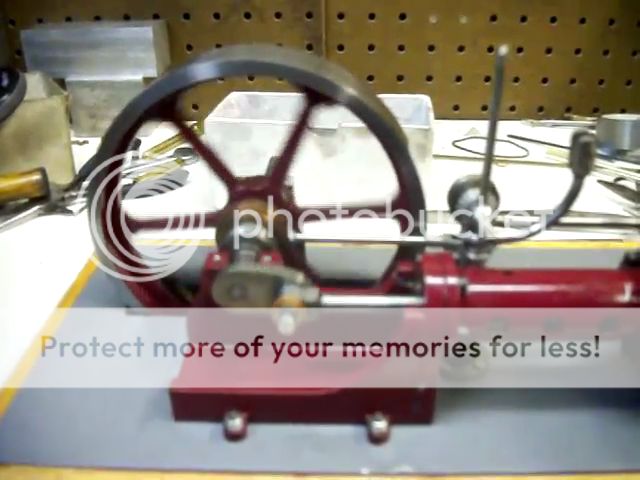

My Bessemer Oil Field engine is taking a lot of design time and not affording me much shop time.  At the moment, I'm waiting on a 1/16" NPT tap and die set, so I decided to start on another engine that would let me make some chips while I'm not able to work on the Bessemer.
This is a compressed air powered engine, 3/4" bore and 3/4" stroke.  It will be as close to lookin like a Lister D engine as I can get.  I've always had a fondness for the Lister D because of it's simple, utilitarian design.  It will be a 4 stroke engine and will use my slave exhaust valve with a cam actuated inlet valve.  Here is a picture of a full size model which has a 3" bore and 3" stoke.
Here are some pictures of the block that I've started...
The block is made from 2" square aluminum bar stock and is about 3.625" tall.  It will have some further shaping done on the outside once I finish all the internal machine work.

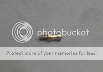

Got a little more done over the past couple of days.  The kids and grand kids are staying with us for a few weeks and I don't have as much time in the shop.
I finished the crankshaft and the crank bearing block.  The bearing block is made from cast iron and the crankshaft is all turned from a single piece of 1 inch diameter 12L14 steel.  Got a nice fit and finish on the crank.  Here's some pics...
Chuck
